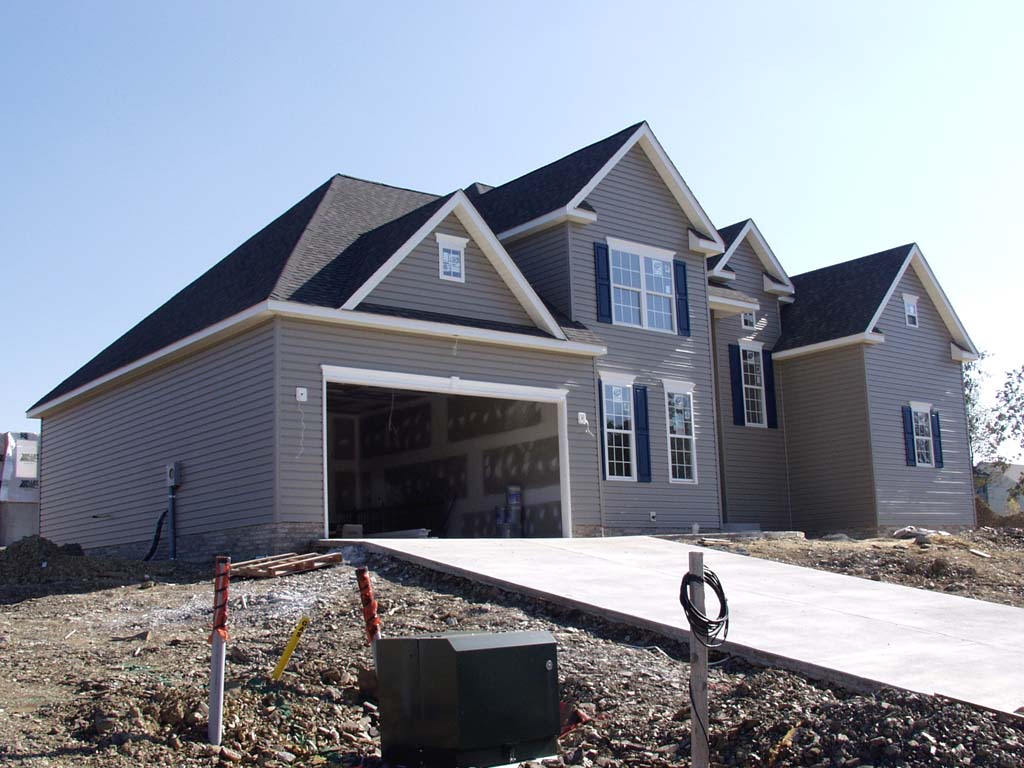

Notice the 6' level before the driveway drops off, you have no idea how I had to fight with the builder to do this. They wanted the driveway to drop right off the lip. I told them I have two motorcycles to get in there and need to stop on level ground, then back them in. I won of course :fu:
I built this house in 2002. I had the garage bumped out 2.5 extra feet in the front, so I would have more room in the front and back. Wish I had gone 4', but next time I will!

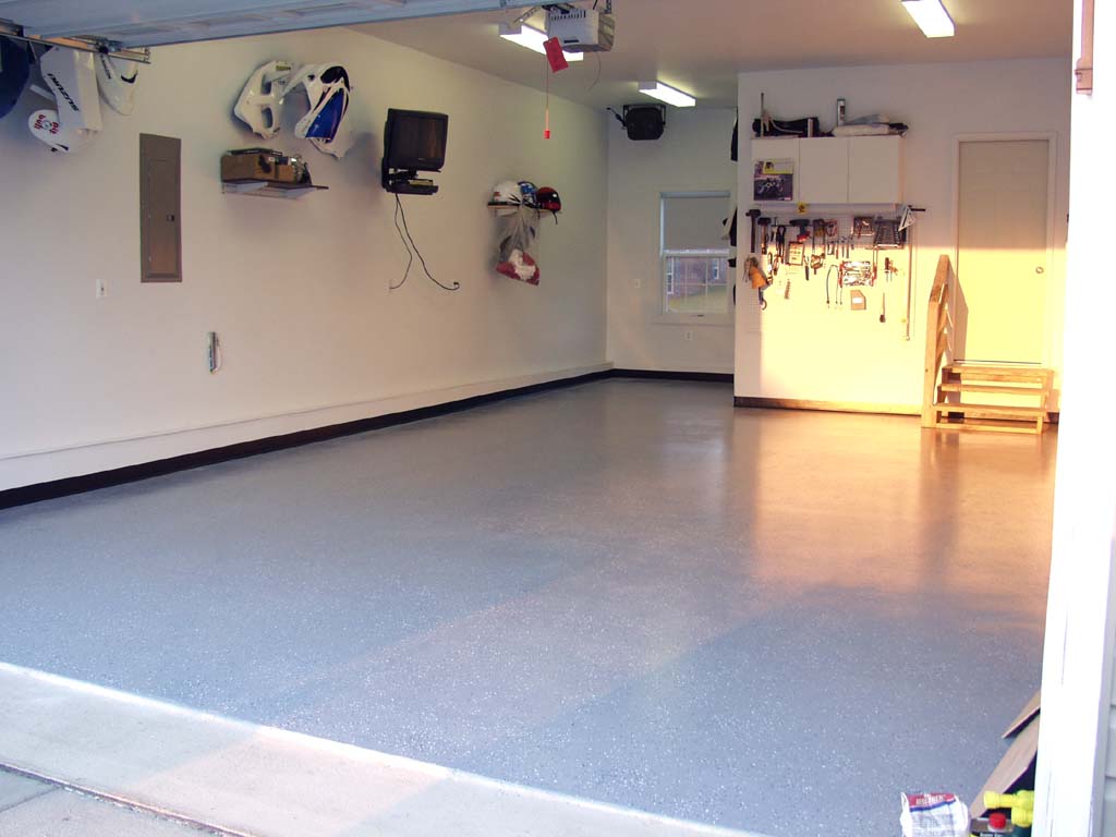

I then epoxy'd the floor and then went haywire and boxed all the concrete in and put cove base down.
BTW, all my Craftsman Tools are setting in the Kitchen while this dried. My cousin came by and walked in the kitchen and said "Love what you've done with the place" My wife was less thrilled.

an epoxy floor!!! Wow very nice. You can run a gas gan however it is easier to just run it straight to the carb for moving it a little... run a line to the inlet side of the fuel pump from a gas can and you should be good.
you will have no prob when useing a gas can but remember to plug the return fuel line so that you don't dribble gas over that nice epoxy floor and drive way ramp.
you want to keep the wifey happy right..... ;)

And a word to the wise. If you do epoxy the floor, skip the flakes. It's a bitch when you drop a screw !!!
I never understood why people add the flakes to be honest..... to each his own ;)

i wouldnt have put the flakes down, you will have trouble later down the road when your searching for that missing screw lol, your concrete is going to crack, that garage is what at least 20'x20' and concrete is supposed to be cut in a 10'x10' square maximum, sorry dude
Been holding for 7 years! Sorry Dude :D
