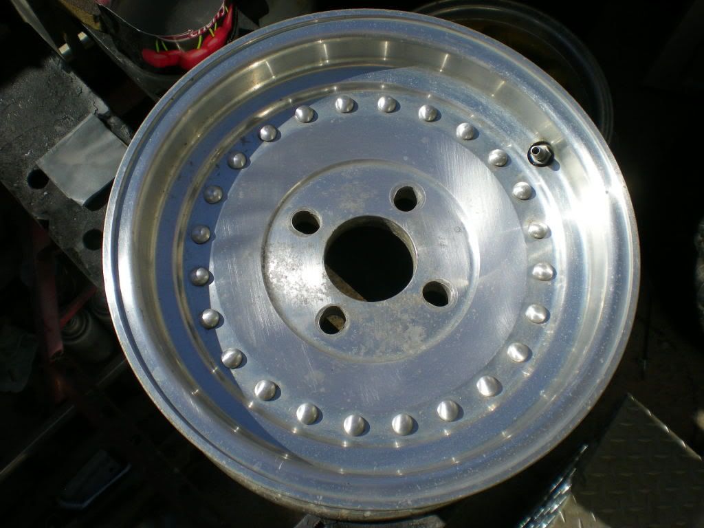

LeDevil Posted May 9, 2009 Report Share Posted May 9, 2009 Just wanted to say thanks for the tips on cleaning up my rims. I had a idea on how to do it but you helped so thanks :thumbsup::thumbsup: from this To this !! :D:D Front Left Left Rear Quote Link to comment

dat521kid Posted May 9, 2009 Report Share Posted May 9, 2009 damn!! awesome outcome Quote Link to comment
Pacific coast Datsun Posted May 9, 2009 Report Share Posted May 9, 2009 Hey wow they came out nice! My general rule, the more you sand em the nicer they look. Glad to help out:cool: Quote Link to comment
LeDevil Posted May 9, 2009 Author Report Share Posted May 9, 2009 Thanks guys for the comments, I think when I re do them I will actually clean up the casting on the spokes they aren't as smooth as I like Quote Link to comment

71DIMER Posted May 10, 2009 Report Share Posted May 10, 2009 What grit did you use? I polished my Talon's, but I want to refinish them... Share your process! Mark and I have shared polishing tips so here's my process with steps & pics. I think I could get them brighter if I used my polishing kit (rouge and buffing wheels) but not bad I think for all hand. Before: Simple Green to clean: Sanded with Scotchpad: Wet sanded with 400 grit. Wet Sanded with 600 grit: Wet Sanded with 1500 grit: Polished with Mother's Mag Wheel Polish (by hand) 1500 grit on left, polished on right Quote Link to comment
