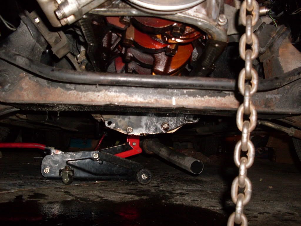

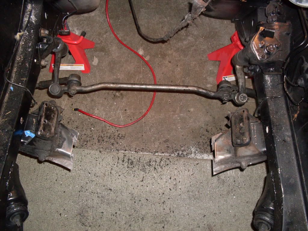

1969DATSUNMan Posted April 15, 2009 Report Share Posted April 15, 2009 I am working on a 12 valve ka24e swap having problems with the center link bumping the slave . I customised the oil pan to clear the center link (rear sump) I am thinking Rack & Pinion may be the answer any one done rack on Datsun 510? What rack did you use? Got pics? thanks for the help! Quote Link to comment

1969DATSUNMan Posted April 16, 2009 Author Report Share Posted April 16, 2009 (edited) I got the slave from the 200 sx got clearance there now thanks Hainz . I am encountering another problem when I am turned all the way to the left the center link bumps the oil pan I have cut the oil pan as far as I can to still allow movement of engine parts. Edited April 17, 2009 by 1969DATSUNMan Quote Link to comment

datzenmike Posted April 16, 2009 Report Share Posted April 16, 2009 (edited) Any one know if you can flip the pitman arm on 510 for clearance issues or will the 620 one fit the gear box I noticed it has more drop. thanks If you mean turn it upside down... no. The splines are tapered and only goes on one way. The 620 arm might work but if it is shorter than the 510, you won't be able to turn as tight before hitting the stops. I am working on a 12 valve ka24e swap having problems with the center link bumping the slave . I customised the oil pan to clear the center link (rear sump) Seems to me you need a front sump pan from a 240sx KA. The rear sump is for a truck which has the steering across the front. The 240sx has the steering across the back like a 510. Edited April 16, 2009 by datzenmike Quote Link to comment
Icehouse Posted April 17, 2009 Report Share Posted April 17, 2009 What KA is that? Is it a single cam out of a truck? Looks like one to me since it doesn't have the "frying pan" under the mains. It looks like the motor mounts are in the "correct" holes unlike normal KA swaps that require moving the mounts to the lower holes. I think you need to raise the engine. The KA truck mounts are designed different than the KA car mounts (I noticed this when doing my KA swap in my 620 using a truck KA) Using the KA CAR steel mounts the ones that go to the block. Then use the 620 engine mounts, that will get your engine higher giving you way more clearance. Also if the steering link hits under full lock its no big deal, how often do you turn the wheel that far? I don't see the point in building custom engine mounts because of it. Just use what I've stated and call it a day. Post some more pics of different angles of the pan mounts and stuff. Quote Link to comment

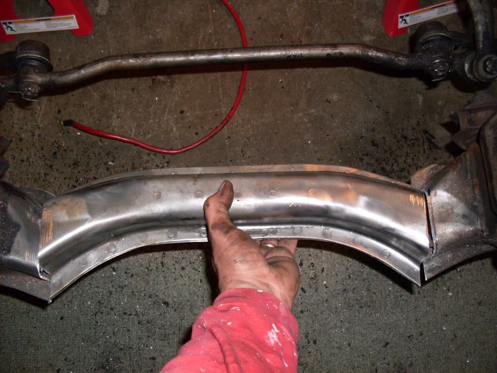

1969DATSUNMan Posted May 11, 2009 Author Report Share Posted May 11, 2009 Crossmember 180 is the answer! So I finally tracked down a front sump oil pan and oil pick up Quote Link to comment
