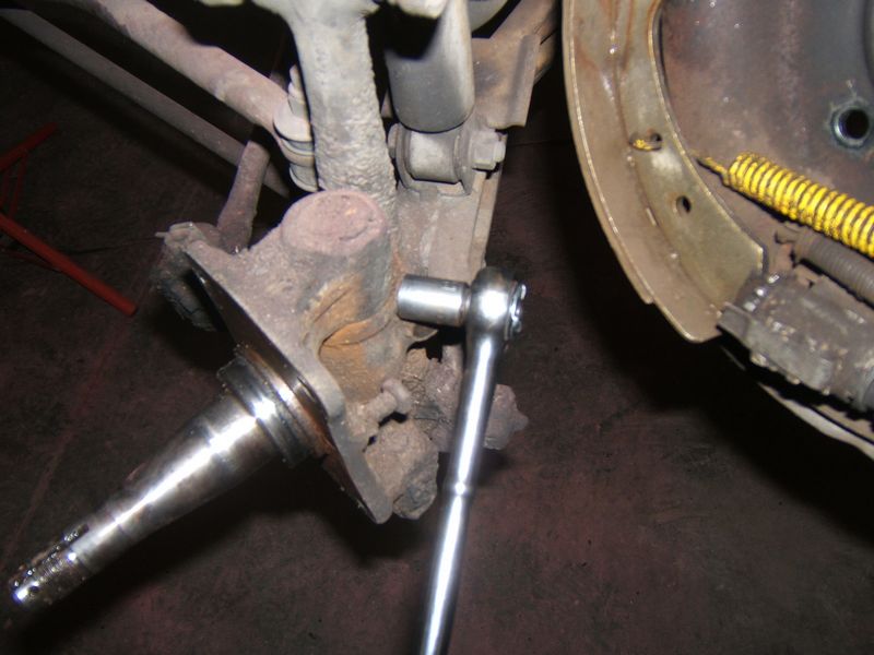

If I could jump in with a question of my own. Is the 78' 620 considered a kingpin having the discs upfront. And if kingpin could be explained
Disc brake has ball joints and is not a kingpin truck.
Kingpin is just like it sounds 1 pin that is held by the axle and the spindle is connected to the pin at the top and bottom and pivots. It's one of the oldest steering joint designs there is.
Kingpin
Ball joint.
