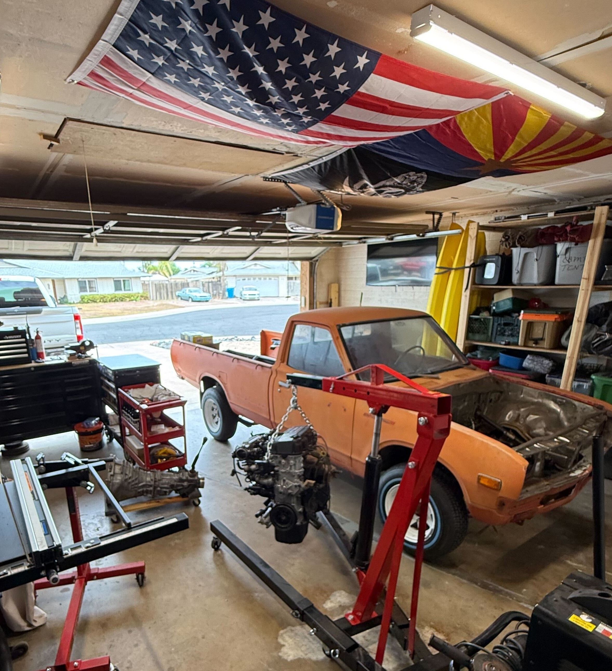

  8. Progress report. Crank girdle notched. Just need to swap the support bracket from the 240sx oil pickup to the truck oil pickup. Looks like I have a welding situation over at my house tho. I use to keep my welder at my grandfathers house back when I didn't have a garage. Since I have been at this house I just assumed the plug was the same for the dryer and I could just use that when I need to weld something.... wrong... the plugs are not in fact the same. 🙃 So now I gotta figure something out.
  9. I know using the this block comes along with some pains. Mainly the oil pan situation and crank girdle. But I got this engine for a song and I have faith that it’s in good condition. I cleaned up the L20b and traded it for the transmission I needed and a disassembled KA24DE that I’ll use the pan and oil pickup from for now and possibly rebuild the motor for a future project. But, I was happy to give the kid plenty of parts for his datto. He was more that appreciative and even tho I may have lost out on the deal I was happy to give him stuff for his truck he might need.
  10. yeah I lucked out in the rust department on this one. The battery area was really the only bad spot. Everything else is surface only. Couple pin holes in the driver floor pan but almost unnoticeable.
  11. Well since I have been lurking in the shadows of Ratsun as a voyeur for sometime now I guess it's finally time to make a profile and be part of the crew. Been working on this baby since March. Gonna KA swap it like the "cool kids" ...why not.
