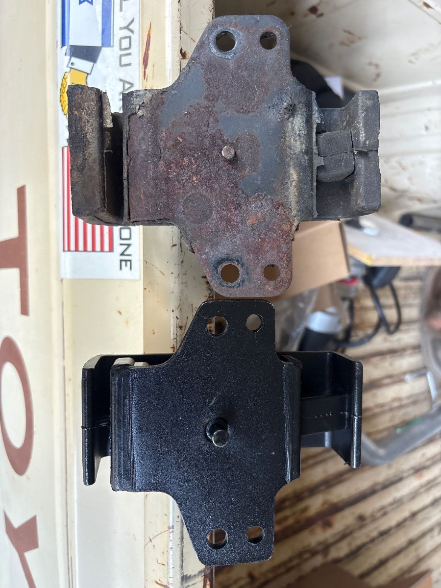

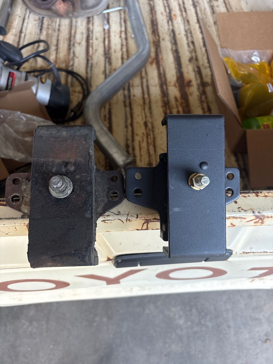

  3. Both Photos are of a new and old mount for comparison.

  5. The one you pictured is much flatter and appears to be considerably larger in diameter. I doubt it would fit in my trans. The one that chrashtd420 suggested looks identical in shape just hoping it's the same dimensionally.

  9. I need help in locating new motor mounts for my 85 720. I have ordered two different sets that were supposed to be for my truck. The first set was not even close. The second set is close But are not the same. the stud that Mounts to the engine bracket is higher than the centerline of the original. They also stand approximately .160 thousands higher/taller than the originals. further the locator pin on the engine side is slightly off and will not fit into the original engine bracket. also the locator pin on the frame side is larger diameter and will not fit into the frame in the passenger side. again these are very close but just enough difference that if I were to make them fit I’m afraid the engine would sit to high in the truck. hopefully some ones can provide a place to order the correct ones I need.

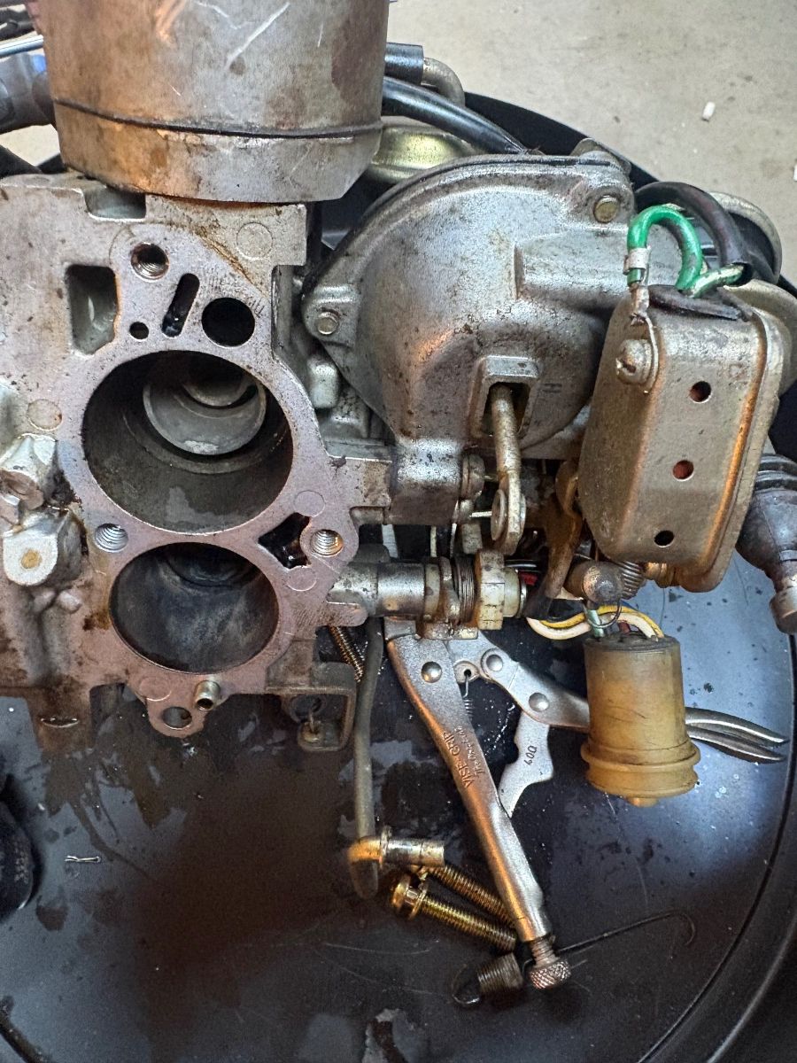

  12. Yes it’s free to move the actuator arm in and out of the actuator body. So maybe it will work. Has anybody had any luck with the Chinese hitachi carbs that are available for about a hundred bucks. In the event this one doesn’t work properly. amazingly prior to the blown head gasket issue I had. This engine and carb ran perfectly as for idle and sensible power for what it is. Now with fresh engine and a hopefully functional secondary it should very satisfactory for a daily driver
  13. Hello my secondary throttle blade was frozen in the closed position. I have taken the base plate off and gotten the secondary back in smooth operation. Is the secondary operated by engine vacuum thru the bore itself. Or does the actuator it’s attached to open it with vacuum. Or is the actuator some sort of restrictive module that slowed the opening of the throttle blade. If it is an actual vacuum module where on the carb is the vacuum line or port to provide vacuum. I wanting to check it’s operation before reassembling the carb but I can’t fine the vacuum source to make it operate. Thanks in advance you guys are great
