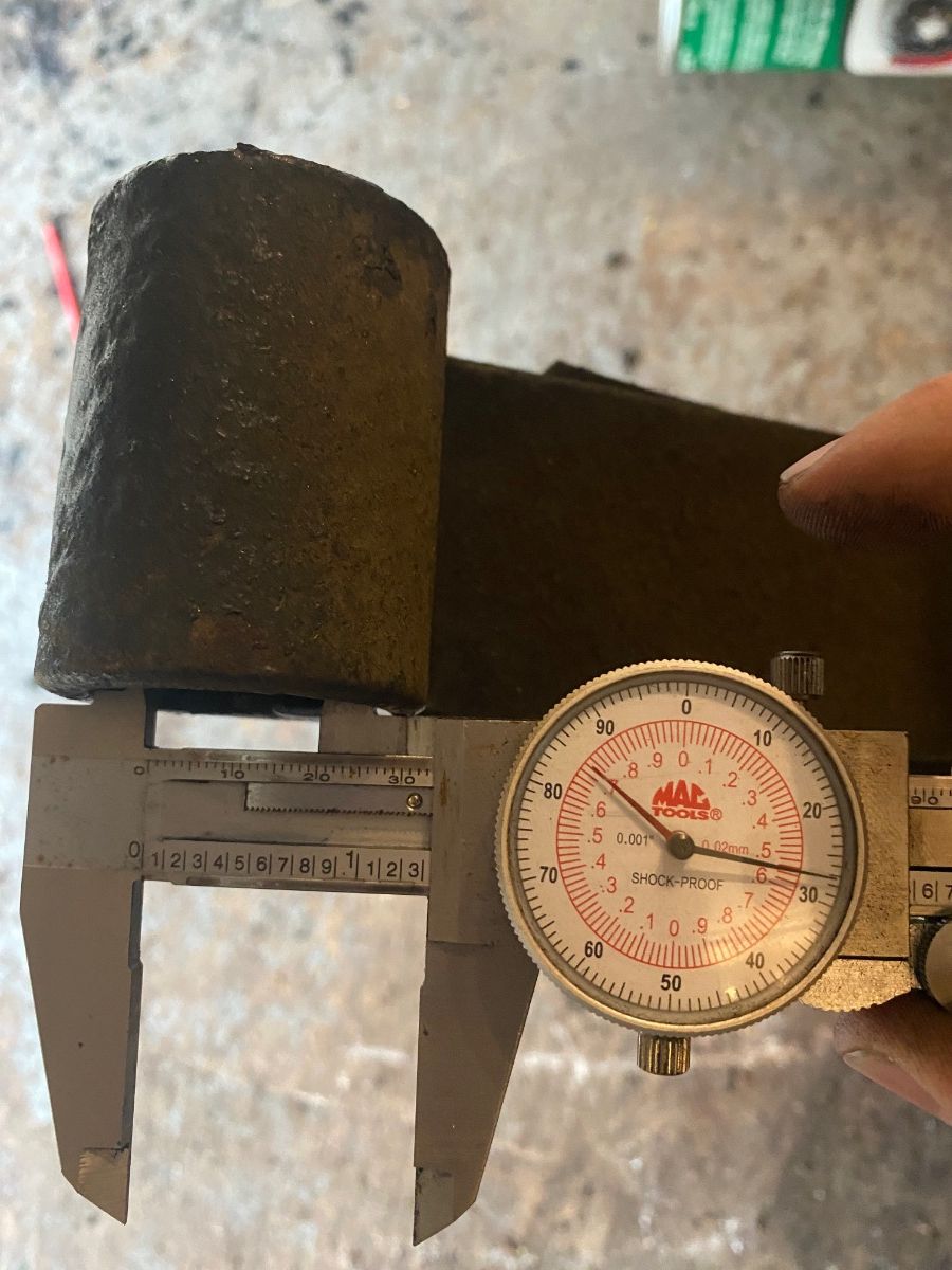

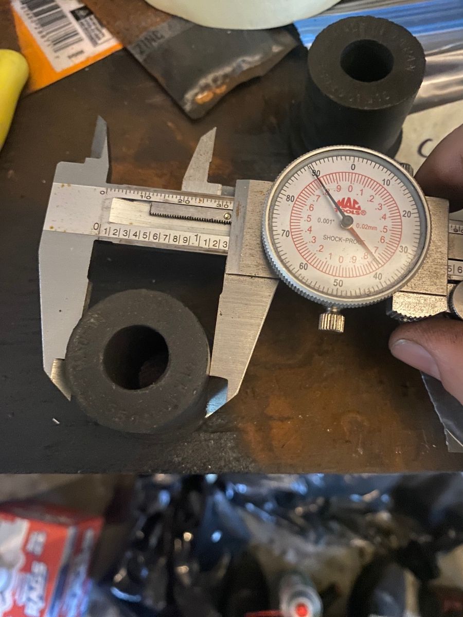

  1. Thanks for the help! I'll look into the jeep bushings. I think also I saw someone say that the 720 rear bushings are the same size as the 78/79 rears. I'll probably just go with the jeep stuff to be safe
  2. Interesting. I thought those were what I ordered but I'll have to check again or maybe get another set from a different supplier.
  3. @datzenmikethat's what I'm guessing, but the options I have to choose from to order all point to this part number. I think I've heard that the 78-79 bushings are different but every website lists the same bushings across all model years. Wondering if 720 or d21 bushings might work if I can also find matching shackles
  4. So I ordered new bushing for my leaf springs and came across an odd issue. The front bushings fit in the spring eyelets just fine and are pressed in nice and snug. The rear bushings, for some reason, are sloppy and don't seem to fit my 78' 620 King Cab's eyelets in the spring or the frame. It's the same with another set of leaf springs that I pulled off of a buddy's truck. Did I end up with the wrong ones or am I going to have to make sleeves for these?
