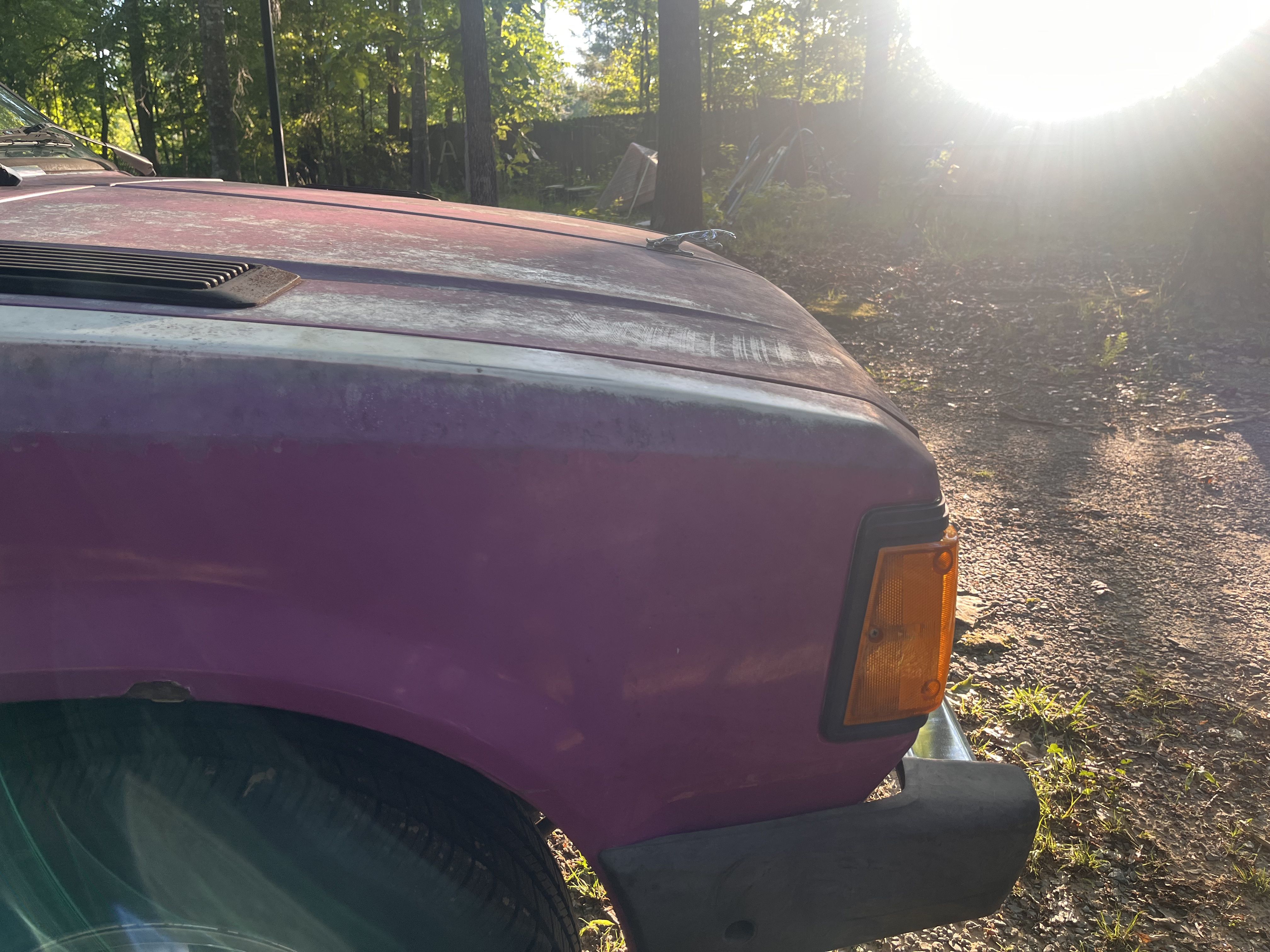

  1. Very nice truck, same era as mine but much nicer. The hood having metal vents instead of the later awkward plastic vents I have is interesting, I never knew they existed. These trucks being easy to work on removes a lot of anxiety about their age and the bucket list of things you have to do on them. You can mostly just get it running easily and drive it hard unlike a Porsche or my Triumph.
