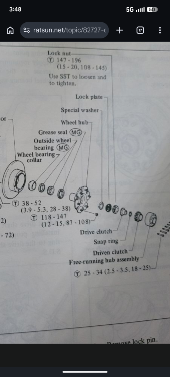

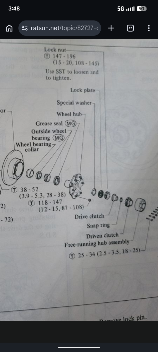

  1. After replacing front passenger wheel bearings, races, and rotor i was tightening the spindle nut to 100 ft/lbs and the two teeth on the "special washer" in the diagram below snapped off. Now I can't back off the spindle nut as it continues to spin and I am in need of a new special washer. I can't seem to find a new one online so far. Help would be appreciated on how to get the spindle nut off now as well.
