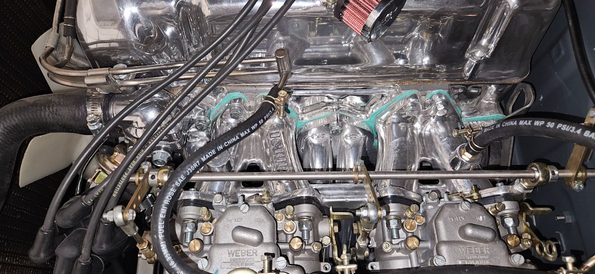

  3. Would you suggest using blue thread lock on the holes once I tap them or like pipe tape?

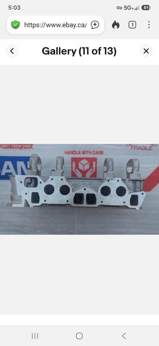

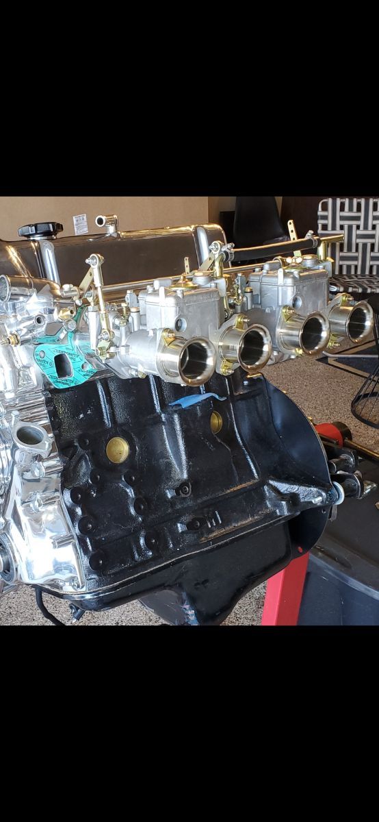

  5. Hello, I'm looking for a head for a l20B that could be built for performance. I have heard the U67 heads are the best bet. Correct me if Im wrong. The current head I have has the water ports on it and it leaks. Ive tried new gaskets,new header studs/washers. I really would like to buy a head that doesn't have the water ports so I can be done with the leaking. I would be willing to buy one if anybody has one for sale. I found a pic of what Im looking for. Not really what the price is for a reasonable buy?

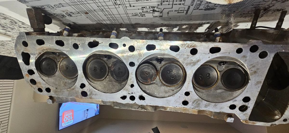

  8. Can anyone make out this head? It appears the head number was sanded off. Its for a l20B.

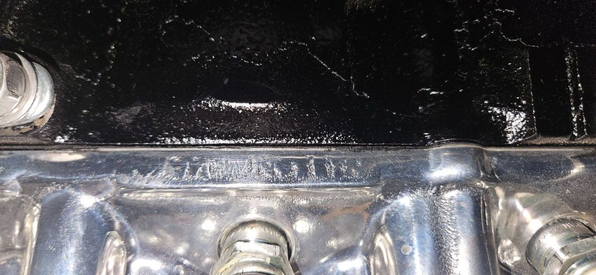

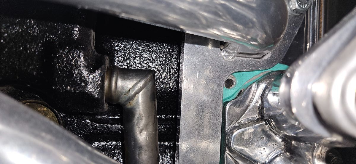

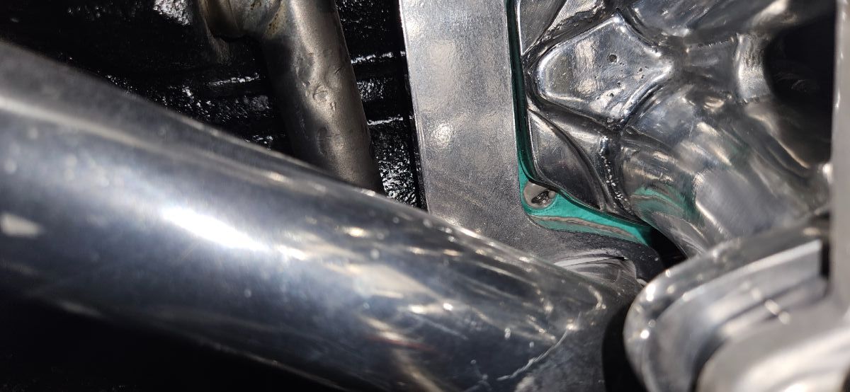

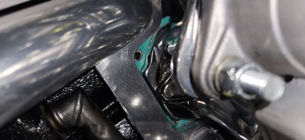

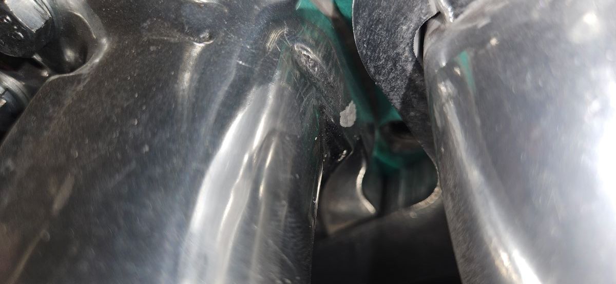

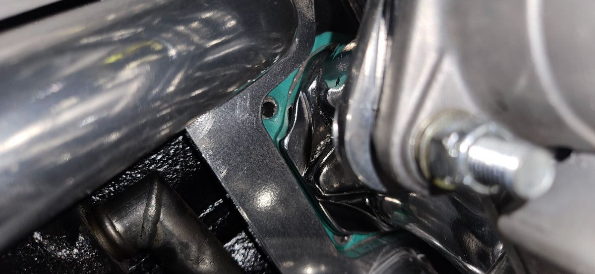

  12. So are these the threaded holes your talking about? Basically your saying put bolts in the threaded holes with washers to clamp down the intake and header to block the coolant.

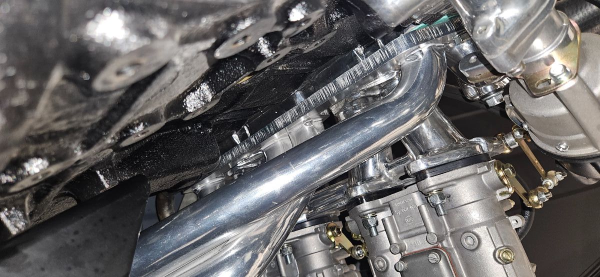

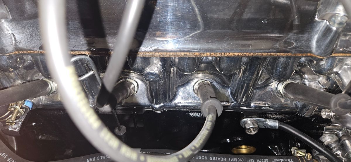

  13. Sorry, I wasn't really clear. It's leaking coolant, dripping off of the bottom of the header. I'm not sure if I missed something during the header install.

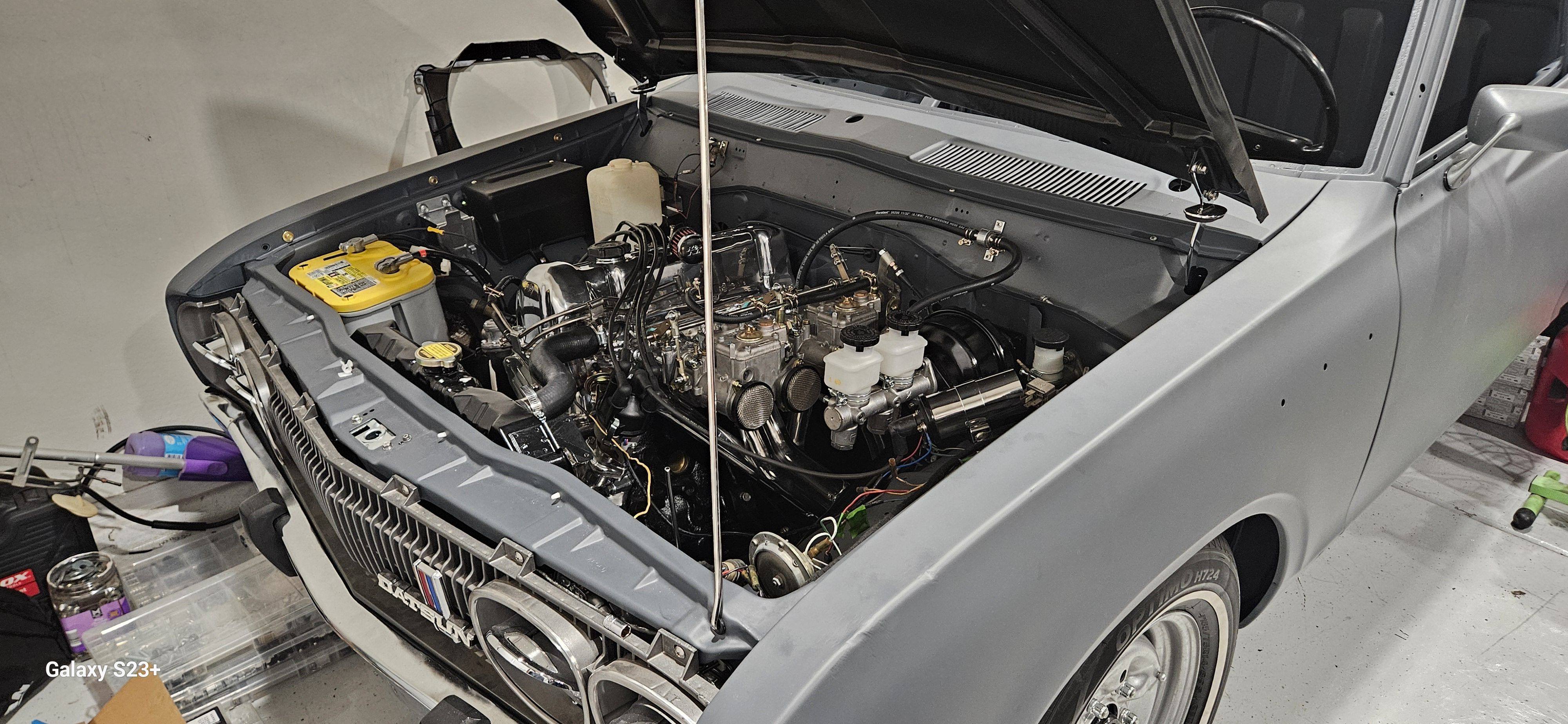

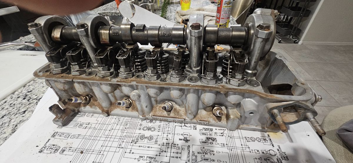

  14. Well my fears became a reality! The L20B I had built from California Datsun immediately started to leak upon startup. I have never done a head gasket replacement before but I thought Hainz made a video at one point. I guess I will put in a street cam while I'm doing the head. Any recommendations on anything else while I have the head off? Gaskets,new springs,anything I can do like polishing? I don't mind spending the money making this thing right. I'm really upset with California hackjobs! 20260822_113650_001.mp4

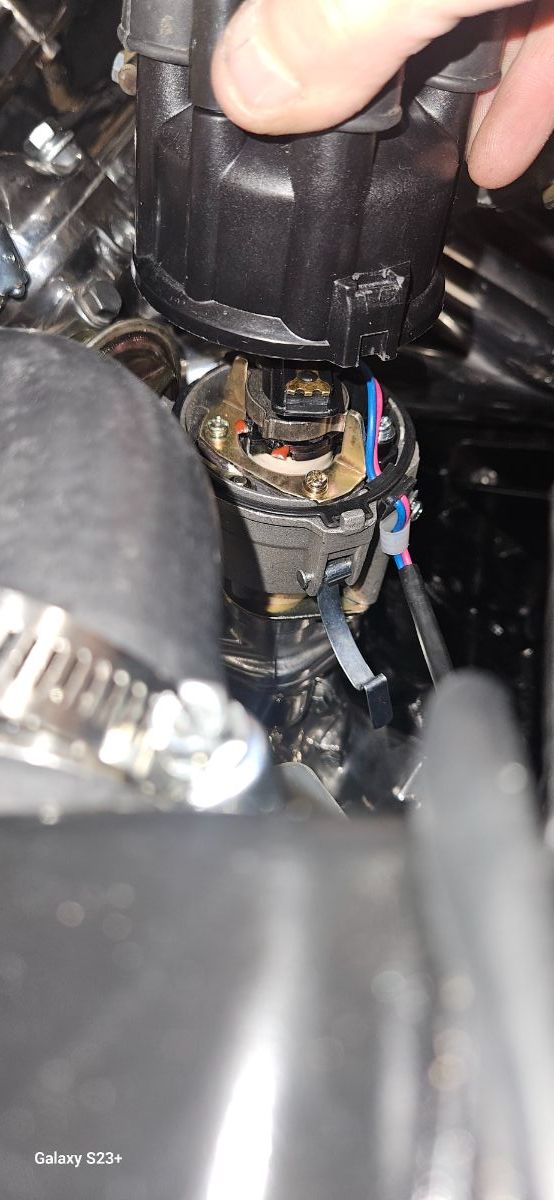

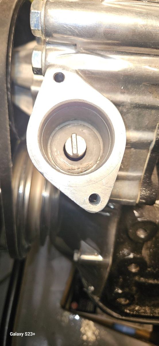

  15. Ok so it's set below a wire with adjustments to the left or right. I think now if I can get it fired up I can adjust it with my timing light, right? How does it look?
