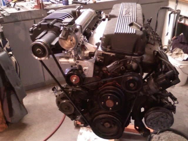

  3. What’s up boys. Been gone a while. I’m back. Saw this on Facebook recently cause I was pondering force feeding my single cam with a draw thru carb. Then saw this post! Too fun. Thought I’d share. He’s using an exterra/frontier blower. I was also thinking about a blow thru carb setup with a truck intake. Adapter plate would be EZ. But I’m growing tired of fiddling with carbs anwyay….
