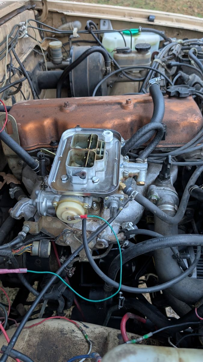

  1. So you managed to stick a z24 distributor in a ka block? Do you have more details on the build? Which intake are you using?

  3. I think what I'm going to end up doing is just go to a junk yard and see what I can find, if I can remove a ka and the harness from a d21(no 240sx available near me). If I can get the harness figured out I might just do the head swap since that will be best for ease of use and it looks like a ka distributor and oil pump driveshaft will swap into the z block. That would give me full use of the ka electronics without having to worry about motor mounts/oil pan mods. I've got extra motors so I figured I'll pull one to rebuild from my other trucks and mess with seeing if everything will line up.
  4. I've found lots of stuff but nothing that's a clean how to on the wiring part of it and no one seems to sell the can-am boxes anymore. In addition wouldn't I be better off finding a 4x4 d21 since it would have a oil pan for the front diff.
  5. If I were to run the dual plugs, keep the timing low and get rid of the vacuum advance do you think I would be good with less than 8psi on a turbo
  6. So my best bet is finding a d21 for the trans and a 240sx for the harness and motor? I'll be honest I tried looking at the route of just doing a light turbo on the z24 as well with a blow through setup <8psi but the problem ends up being the hypereutectic pistons and no one makes anything but factory style pistons for the z24
  7. If I were to go ahead and just swap a ka-e into my truck what's the best way to wire them up? I've seen some stuff saying that the factory ECU for the ka is separate from the chassis harness for the most part. Is there any good write ups on this? I've only found tid bits of information. I messaged redeye to see if they still sell mounts.
  8. I thought the c series used different ratios like the b series did but I just looked and I've only been able to find one set of ratios for a c series.
  9. If I do a c series swap I would need to find two c series transmissions and use the gears from a 4x4 case in a 2wd case. Is there even anyone who still sells the swap mounts? I know that the can-am box isn't sold anymore and megasquirt efi stuff is expensive and not very plug and play.
  10. Part of the reason for this is to get rid of the carb for a simple efi unit. From what I have found the efi unit can operate separately from the timing control so one would just set the timing as normal.
