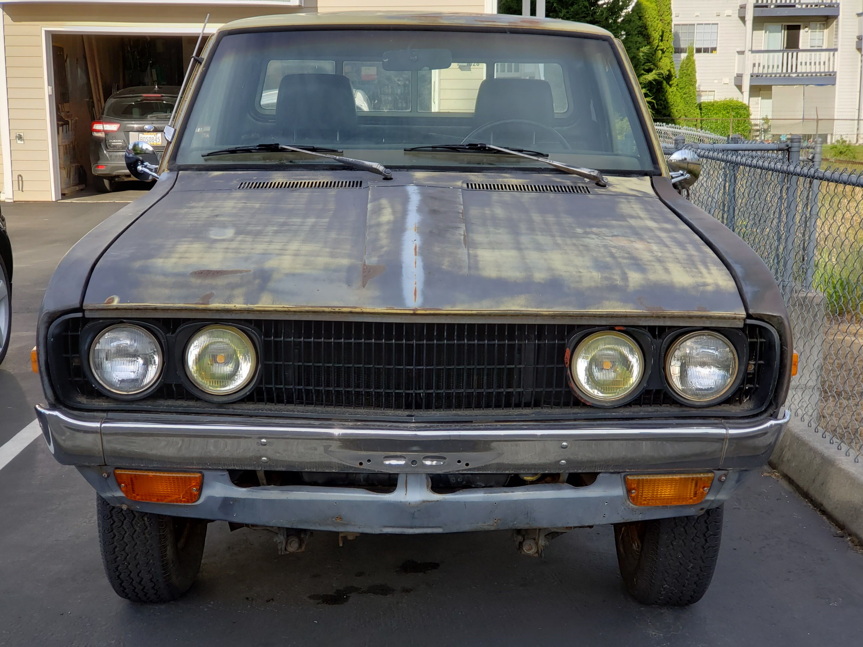

  2. Entry 35 - Cucumber town! It looks like I got the cooling issue fixed. I ran it around the last couple days, then flushed it a couple times and replaced the thermostat. The water never quite ran clear but it wasn't as filthy as I was expecting. A little brownish and murky but not "tap water for 15 years in the rust belt" brown or anything. I would have let it more but I used up all 4 jugs of distilled water I had. I'll do it again next summer. I let it idle for about a half hour, with the heater off the last 10 minutes and the needle never went past halfway. Looks like I'm good to go. I replaced all the soft fuel lines under the hood and made sure the clamps were secure. The filter and all the lines drained out obviously in the process. When I went to start it it pulled fuel and turned over after a couple cranks. Hopefully that's the end of the fueling nonsense. We'll see after it sits for a few days. I checked the torque on the nut for the fuel pump lobe and it's good to go so hopefully there's no issue with the pump and it was just a leak down problem with the old lines. I put yellow Lamin-X on the low beams and ran a new fog light harness for them. Much brighter now. They will make great fogs. I should upgrade the LED assemblies to modern relays as well. I'm a little surprised the engine notably loads when I turn on the fogs. I was hoping the new alternator would prevent that. Nothing in the rest of the system dims though so that's good. 3 things down, 20 to go.
