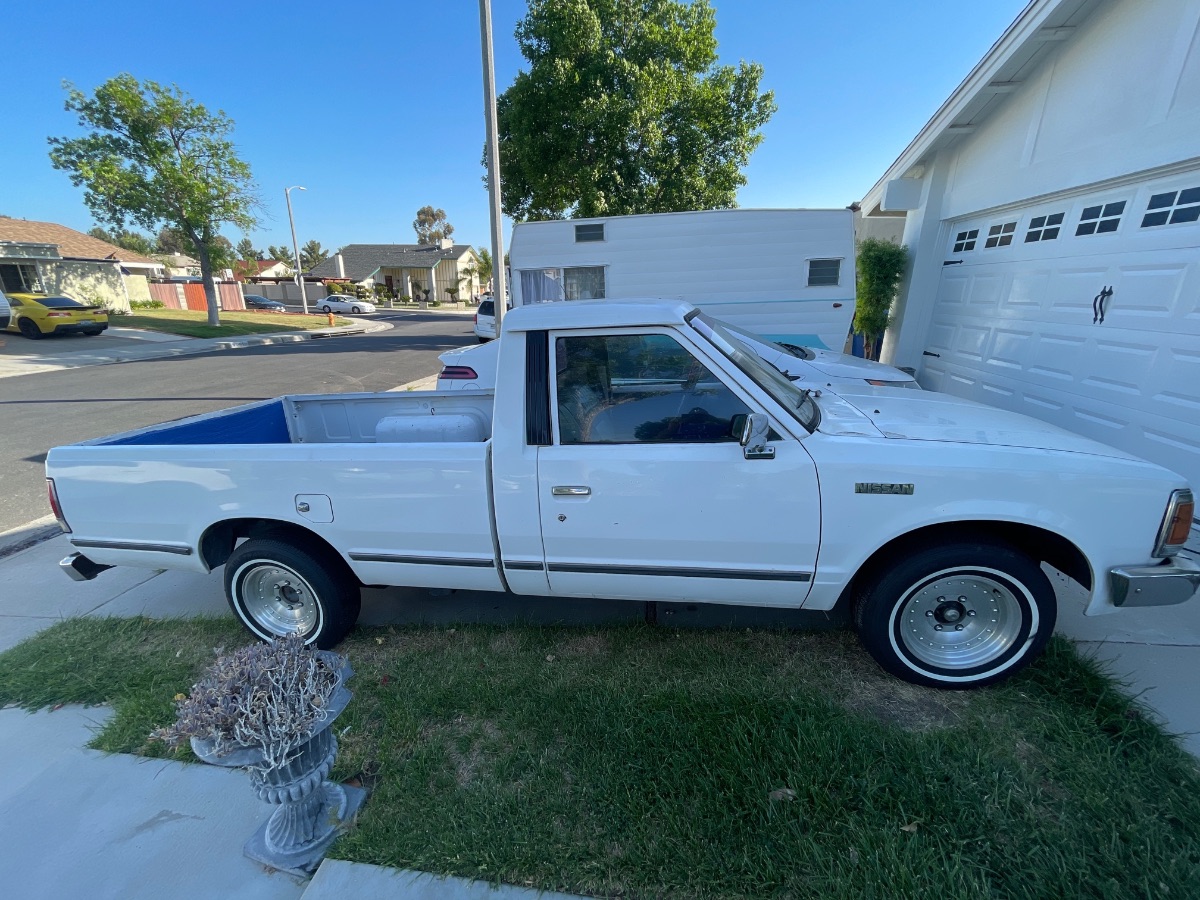

  3. Z24 Engine. Replaced the fuel pump today and it turned over like a champ. It hasn't run this well for months. Thank you all for the input. This forum is the best.
  4. I changed out the fuel filter and drained the tank 6 months ago. I decided to change the filter out again three days ago. It's my sons truck and he changed it while I was at work. He thought the fuel pump was the filter so he disconnected the hoses and the wiring, then he realized it wasn't the fuel filter. He reconnected it and Now it won't start at all. The motor turns over but acts like it's not getting any gas. I will look at it later today but perhaps the fuel pump has gone bad. What's the best way to know if the fuel pump is bad? I'm currently going through the youtube rabbit hole of how to determine if the fuel pump is bad...
  5. When it gets back below 40 mph the power/fuel comes back.
  6. Hey y'all. My '86 720 has started to buck at around 40 mph and loses power/fuel and bogging down. What are the possibilities for why? New Weber Carb installed 8 months ago. New spark plugs, wires and distro cap 7 months ago.
