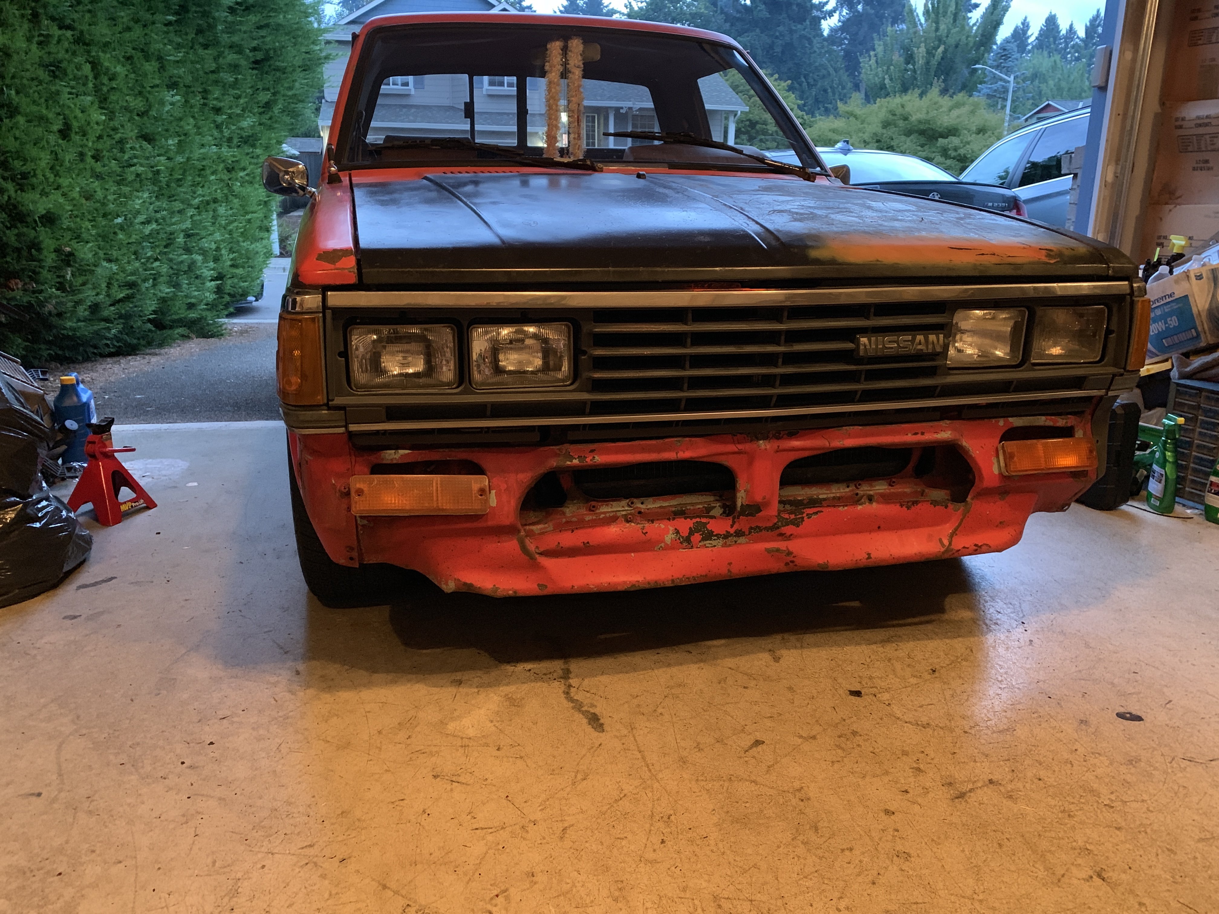

  6. Like extremely off. Also wouldn’t it be smoking if it was head gasket? One of the neighbors thinks it could have been possible to have a loss of oil pressure. But I don’t think that would cause it to rough extremely rough like it does right? It would have died on before I got home I would have thought. If it’s just the head gasket, I’ll be happy.
  7. It was off. When I was driving it would feel like it had no power. Timmy G and I decided to do the timing and it was runing great like I said for all of about 10 minutes.
  8. Ok thanks mike. And yes it was set to 3 degrees BTDC. I drove it from my buddies house home to my place and it sounds like piston slap at certain rpm. I didn’t take it over 2500rpms. It didn’t make it up my driveway and then just wouldn’t start.
