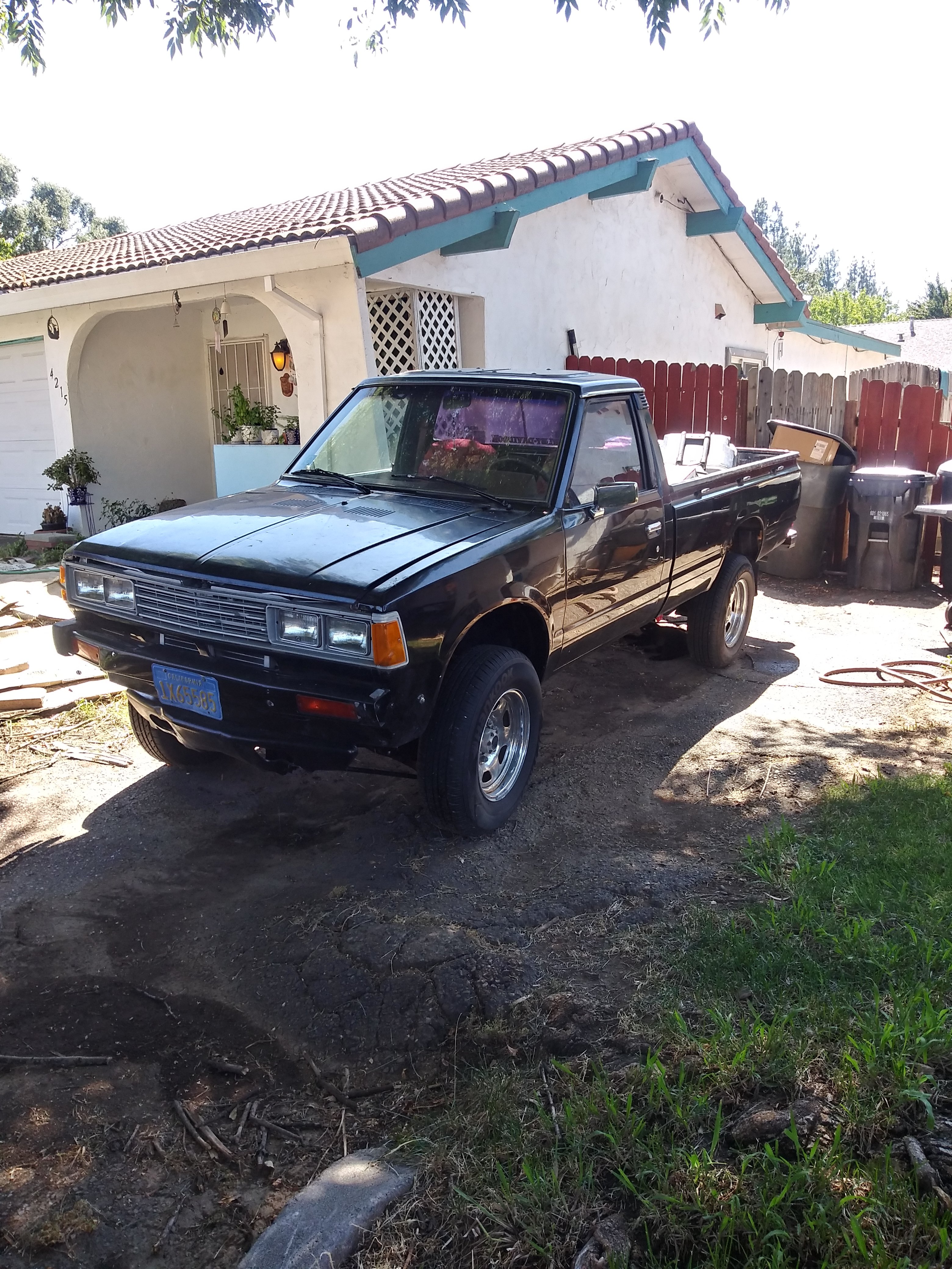

    Hate to let it go. Fine specimen. L20B needs engine work or replaced bcuz chain tensioner came out with engine running. Everything else is good. 4wd works flawlessly. A/C blows ice cold. New tires. New alternator. New EI distributor, new carburetor, new plugs and wires, new battery, someone with mechanical know how will have themselves a great truck. 173k miles. CA registration is in limbo due to smog. I was trying to get it ready to smog when engine got stuck due to my screwing up after replacing the head gasket, which was leaking from timing cover after I replaced the timing chain. Original. Classic in excellent condition for a 40 year old truck. Has tow package installed. Clean title.
