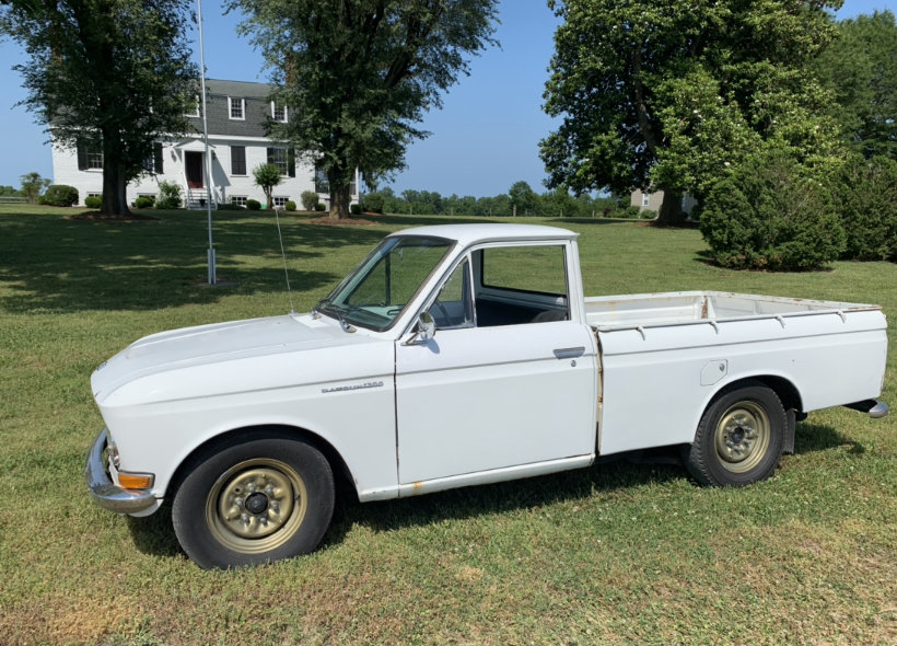

  5. Time to buy more parts and wanted to get some input first. Remember I’m fitting this L20B in my ‘68 520. I know there will be cutting and welding but was trying to stay away from cutting the firewall. So I need to get a water pump and a radiator. What do I buy? Do I go stock, ‘78 620 water pump with clutch fan (that was original to the engine). I don’t see any original style radiators on eBay, only aluminum ones. Would that combo be too deep and not fit. I heard, and it looks like it’s going to be tight. Also, the ‘68 520 face has four head lights with a space of 23 inches between where the radiator needs to go. What about an L16 water pump with a fixed fan? Will that save space? Any different options on the radiator? I’m looking forward to reading anybody’s thoughts. Thanks
