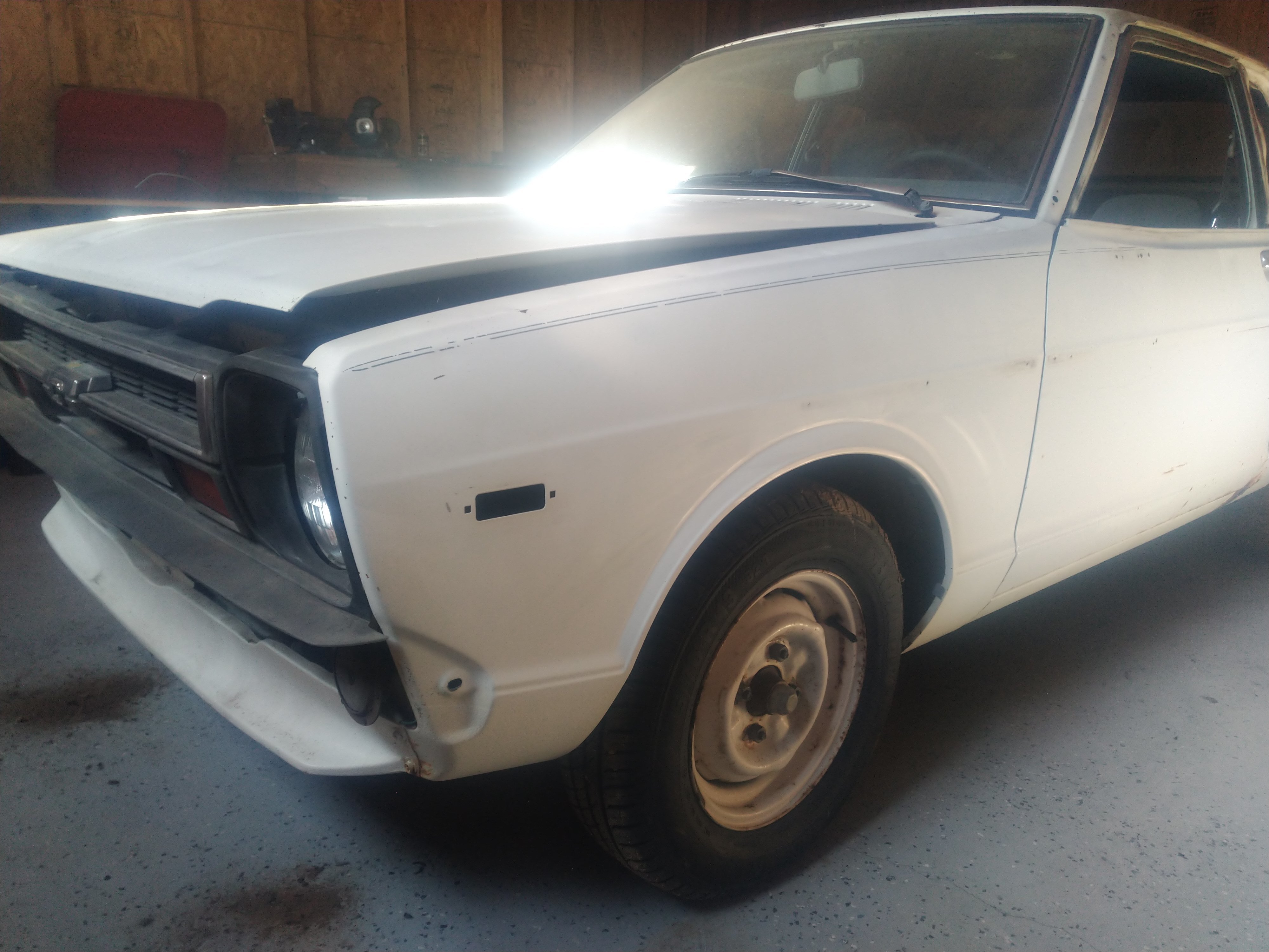

  11. Removed the bumpers, trim and front/rear side lights. Started cutting out the cancer and making patch panels. Going to delete the side lights and trim. Need to source some non-US bumpers, can't stand the original ones. Also going to delete the sunroof. Trying to make it as light as possible. It already looks a lot better without the bumpers. Not sure if I'm going to roll the fenders or add extensions. Guess I need to get some rims soon. Thinking 14x6 with 0 offset. What do you guys think?
