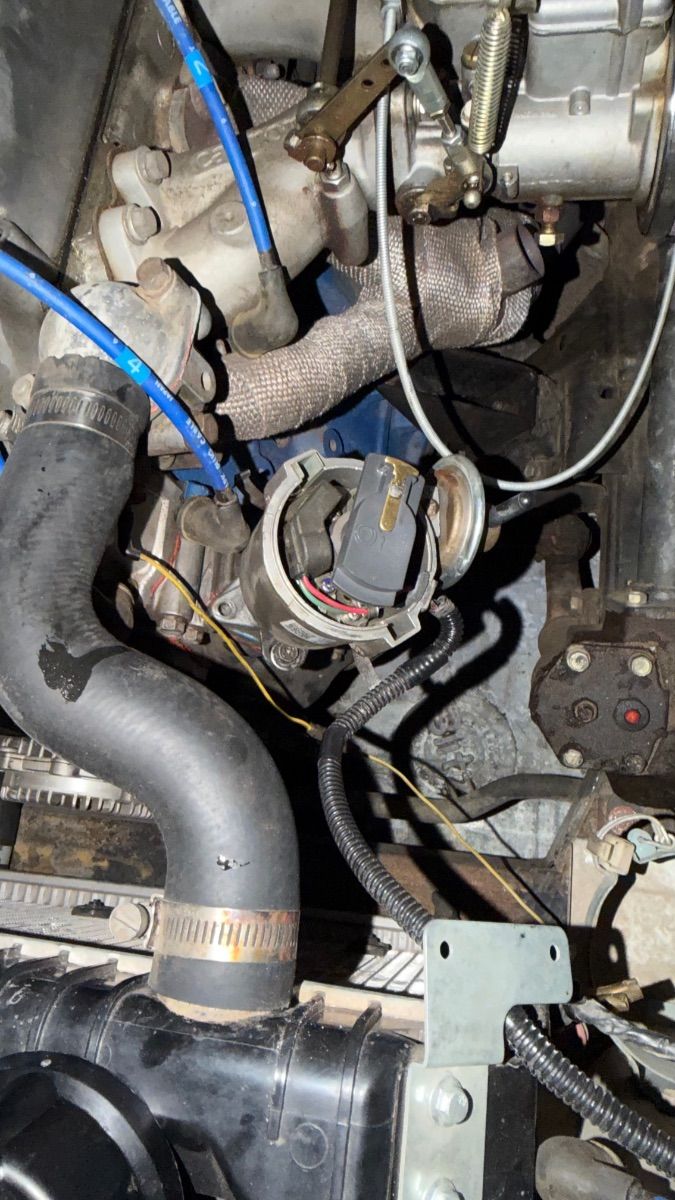

  2. Stock module and got it wired and worked fine. The tuning issue that led me to explore the overall timing again, crank to distributor was that at 12-15 degree advance it would take quite a while to warm up and run smooth. I now realize that something off only a little in that timing area has too large an effect to be my OG problem. I’ve got stellar spark now and i did have a set timing that worked fairly well so now I need to go through the carb I guess. It’s a 45 Italian beauty that needs new O rings, some jetting for 6500’ altitude and maybe I’ll find my happy tune. follow up question: I’m not running vacuum advance cuz I don’t have a vacuum port, and my carb doesn’t have the casting to drill one, where might a guy suck a bit of vacuum to get that advance so desperately needed?

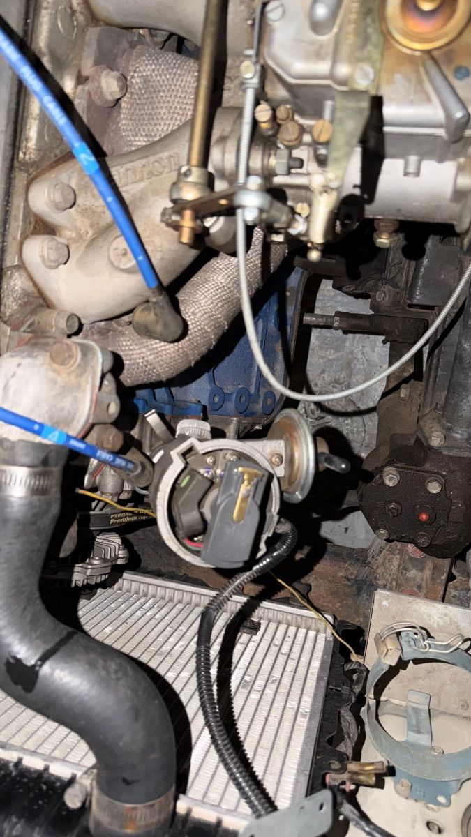

  4. I have had some tuning issues so I started from scratch with dbl checking my timing. Now I’m all turned around with this distributor and I’m not finding what I need in assurance. This is NOT how I had it when it ran rather well-ish. But I had the A/R indicator pointed forward and #1 was towards the driver. Then I noticed the Dist shaft was way off so I now have that at 11:25. So with the cam timing verified, the dist shaft verified, I don’t think I know which way the distributor goes, and I’d be damned if I could find an image online to confirm.

  8. Well, I looked around and came up short of a thread that spoke of my issue. I’m sure it exists... I have a DCOE mounted to a Cannon intake on my l20 powered 620. I’m getting real close on my tune of the engine, I’m doing it all by feel. I do know I’m up in around 12-14 degrees of advance on my timing, I’m not running the vacume advance yet. My question is: cylinder 1 & 4 burn good to lean, and Cylinder 2 & 4 are a bit rich. I imagine that the longer runners on my Cannon intake mix the fuel better than the short runs, right? I was wondering if a hotter plug on 2 & 4 could help? I also wonder, if by chance, my valve adjustments happen to be off a smidge and coincidentally coincide with 2 & 3s rich-ness. (I adjusted the valve cold) lastly, I need to find a fitting thet can screw to my only existing vacume port, on the cannon, so that I can steal a vacume advance line for my distributor. It would have to work the brake boost line and have a small fitting for the distributor. Thanks.
