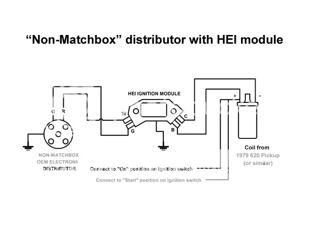

  7. I ordered and replaced the HEI module. Less than $10 to my door from ebay. I think I hosed it when I hosed off the engine. Works fine now.

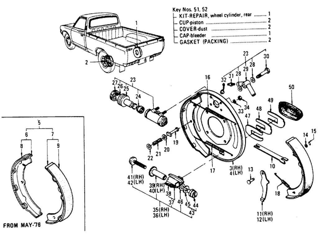

  9. The picture I posted is the left front side on my vehicle. Just like in the diagram. Going forward, the wheel would be rotating counter clockwise. I installed the front shoes on both sides of the vehicle with both small pads toward the front of the vehicle.
  10. Yes it has a power booster. I found the leak on the passenger rear slave. I bought and replaced it. I also found the part #22 in the attached to be worn and not staying on. Is there any reason why this link part will not work. I can't find a kit for a 72 620. I only need #22. https://www.amazon.com/Carlson-Quality-Brake-Parts-H4020-2/dp/B000Q0CW9Q/ref=sr_1_5?crid=1TT9NZ8IPNXEE&dib=eyJ2IjoiMSJ9.aAom6gBdvJysteMZ6NlO4xzrPD_c4pzb8LDA6S4Fx-tAfs3ln0skXpvJqowYFx4mFvq5MIGh6nQJBHQorLB9Gz_VH3cSiILA9vqj_kl9BMXg3sQY39vyJWKJFictag4Y_ls7nWDF3GRfP6DocBo4L1n1RPAj9aJLjwRzNqTOM3sH8goTrDgU9zRJEnC2qbTqH7SKbX8teuwoqxedmlgmW2U4YnAH3lcjfeMa51la2ST3I51t_nkFbCNtEn-oL6JC6rJ3fgXFhh6682podFaJdVJIna8JpssbZ5sfqIfPe0A.alZnC8EVM43irm8kFVKTp_cO3GF9FEFHD4dNInMriAE&dib_tag=se&keywords=1972+datsun+620+brake+hold+down+clip&qid=1723328322&s=automotive&sprefix=1972+datsun+620+brake+hold+down+clip%2Cautomotive%2C136&sr=1-5
  11. OK, So I think I have them correct.
  12. I'm trying to chase down why I loose fluid. I see no leaks outside the drums on the lines, so am checking the cylinders. Good thing is, I see no wetness on the right side. But, did I put the shoes on correct the last time I worked on them?
  13. 72 Datsun 620 About a gabillion years ago I did the electronic conversion in the attachment Trucks been running fine. i took it for a spin and am chasing the hose clamp leaks. When I got back from the spin I noticed the @#$%^ hose is still leaking that goes to the intake manifold below the carb. I changed the clamps to T-bolt clamps and started it up and it ran about 5 seconds and died. Then would not start again. i had a helper crank it and found no spark at the dizzy or plugs. I metered all the voltages and connections in the attached. All still good. I'm thinking I lost the coil or hie unit. Any way to check these or is it just a swap out and see if it fixes it?
