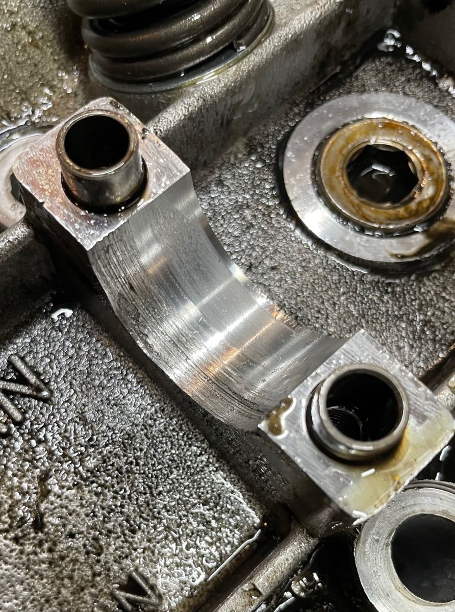

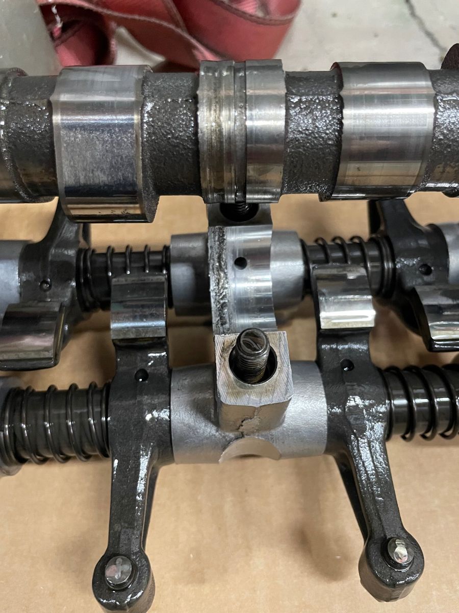

  2. Durabond repair bearings, from what I’ve found, requires machining out the factory bearing surface and installing a steel/babbitt bearing. I might call my machine shop to see if they’ve worked with them before.
  3. It’s actually the cam bearing between 1 and 2, the rest look flawless. I think someone’s been in this engine before and didn’t clean the bearings when reinstalling the cam. Do you have any experience with Durabond bearings? I can probably find a new cam but these heads are a pain to find in Colorado and the cost of a rebuild head is damn near the price I paid for the truck. If I exhaust all my options I may try to run it as is and the KA oil pump is a good idea regardless.
  4. Finally starting to work on my 85 4x4 720 and got the Z24 pulled out. Diagnosed a bad head gasket, as usual, but when I pulled the cam I discovered a problem. Should I start hunting for a cylinder head and cam or could I polish this up and hope for the best?

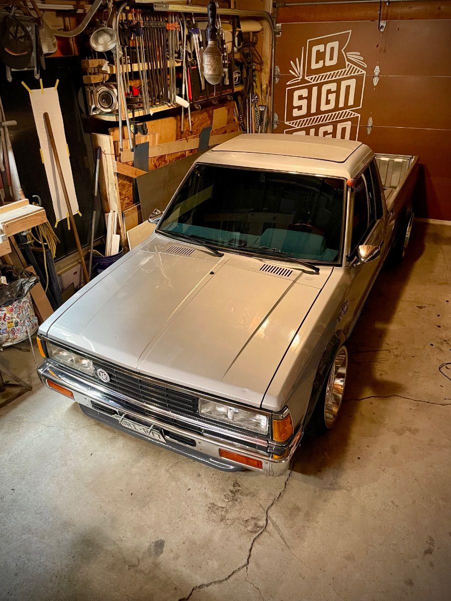

  9. A quick update on Shiro (that's her name). I've been doing little repairs here and there and just driving the hell out of it. Back in February I drove her to Tucson from Denver to attend the roadkill zip tie drags. People were a little confused seeing a minitruck with a roof top tent mounted to it. After selling the tent I realized I needed some sort of sleeping solution for a few trips I have planned this summer. Found a topper on CL for 100 bucks and built a bed platform for a 3700 mile round trip to South Georgia. The trip went well with only a couple minor issues. I currently have every ball joint and bushing new in the shop waiting to get installed so it'll stop trying to change lanes when I hit the brakes. Front brakes will probably be soon after that and maybe I can find the time to rebuild the weber 38 I have for her. Until next time.
