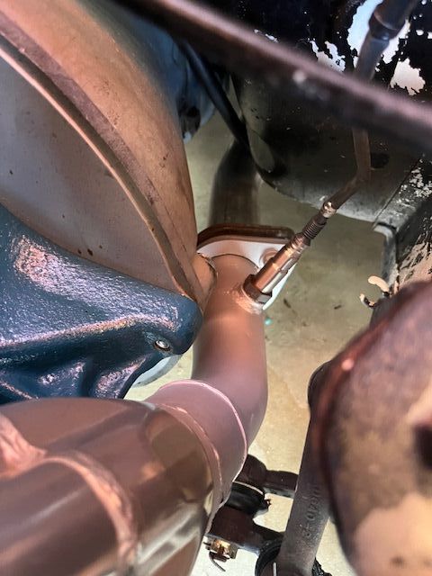

  1. I removed the 2 into 1 collector pipe and had a local muffler shop weld in the oxygen sensor bung. After that was done, I was able to finally start installing the intake/exhaust manifolds. Before doing that, I installed a set of studs for the intake. There were already studs in place for the exhaust manifold, but the stock set up just uses bolts on the intake. I feel like there is a less chance of stripping out holes if studs are used. I used copper locknuts on the exhaust manifold. I found a generic Holley 4-barrel to 2-barrel adapter plate on Ebay and modified it to use on the Clifford intake. I replaced the old, crusty heater hoses with new silicone hoses and routed the coolant from the thermostat housing, through the intake manifold and back into the water pump. A brass tee was installed to accept the additional coolant temp guage. Found another potential paint color. This one is "Verde Gea Matte"

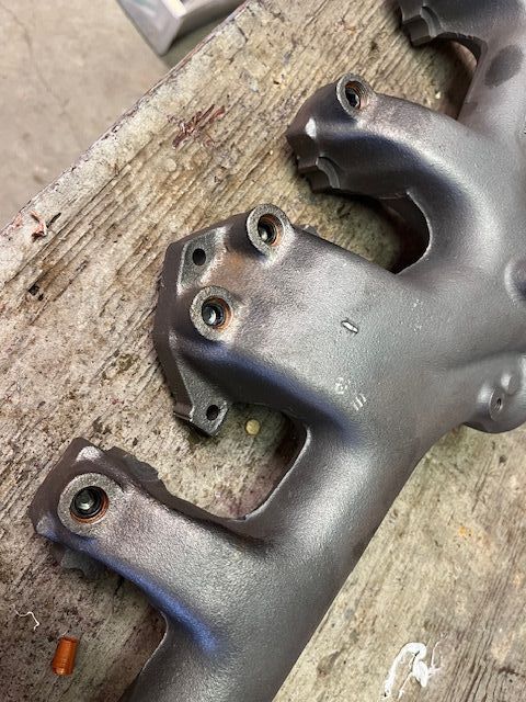

  5. After bead blasting the exhaust manifold, I used a carbide burr to grind down some of the extra material that was left over from the air injection tube gussets. Then, I blocked off the holes with threaded pipe plugs. Originally, I tried to fills the holes with brazing brass, but it just made mess because I had no Idea what I was doing.😂 The paint on this car is in really bad shape, flaking off everywhere. Originally, it was a light blue metallic, but was re-painted red at some point. I'm not a big fan of the red or the blue, so I've been searching for other potential colors. I recently saw a Nissan Xterra with a green metallic color that I really liked. So, I'm posting it in this build thread for future reference. It's called "Pop Green Metallic" color code "JAH" This picture make it look more yellow that it is in person...

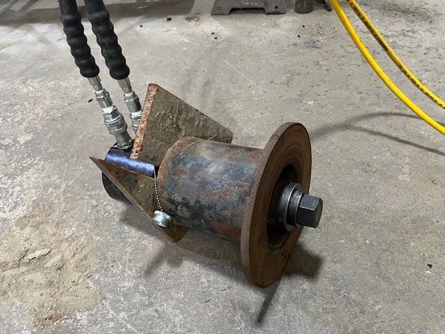

  8. I cleaned out the fuel system by filling the tank with 10 gallons of acetone and denatured alcohol and recirculating it through the fuel system by connecting the feed/return lines in the engine compartment. I had to rebuild both rear drum brakes. Unfortunately the wheel cylinders were beyond saving, so I had to buy new ones. Everything went back together fine, but I couldn't get the auto-adjusting feature with the hand brake to work. The front rotors needed to be resurfaced, so I had to separate them from the hub, which turned out to be quite a challenge. I couldn't beat them apart with a hammer. So, I ended up using this portable electric hydraulic press we have at work. My plan was to rebuild the calipers, but there was one stubborn piston I couldn't get remove. After trying various methods I found on youtube, I gave up and just bought a new pair of calipers on Amazon. This was supposed to be a budget rebuild, but that idea is quickly going out the window. Anyway, after the new calipers arrived, I installed new wheel bearings in the hub and reassembled the front brake system. The old brake master was in bad enough shape, that I had to buy a new one also. Once I got everything installed and began to bleed the brakes, I discovered that the brand new brake master was leaking from the bushing that connects to the front brake line. I tried to tighten the bushing as much as I could, but it still leaked. So, I decided to unscrew it and see what the problem could be. I saw that it had a copper washer that might not be sealing properly. So, I installed a new copper washer but it still leaks. Now I have to decide if I want to go through the headache of returning it, or just buy another one, and hope it doesn't do the same thing. Has anyone else experienced this problem?

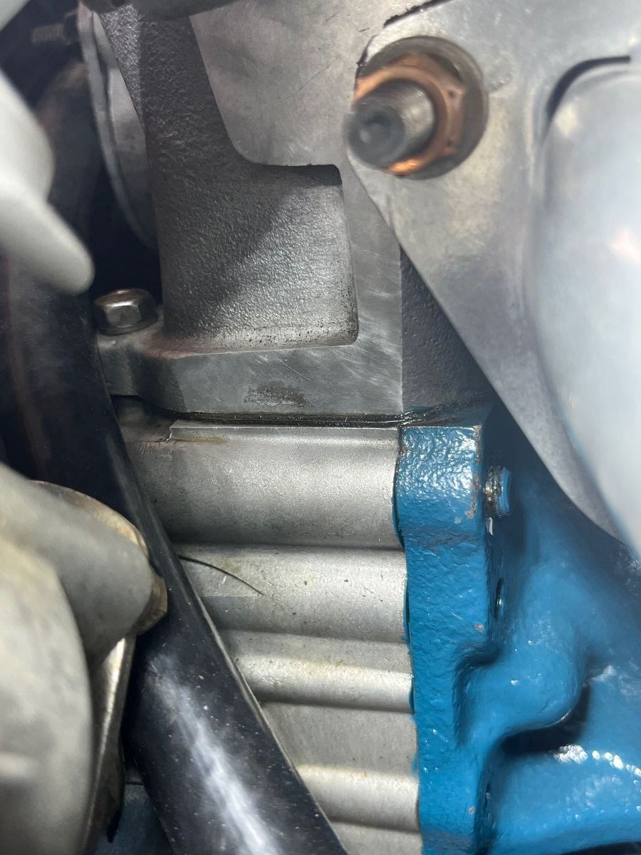

  14. I'm getting a small oil leak along the top of the timing cover, where it meets the head, on both sides. I changed the inspection cover gasket in hopes that it was the source of the oil, but no such luck. See pictures below. So, now I'm looking at re-sealing the timing cover, which I'm kicking myself for not doing before the engine was installed. Is it possible to to do this successfully, without removing the oil pan and head? I've read some posts about not using RTV where the head meets the timing cover. Is this a bad idea even with high-temp RTV? Any suggestions would be greatly appreciated.
  15. When I removed the spark plug, I was able to see that the top few threads were messed up, the ring gasket didn't have a good surface to seal against. I was able to get a copper washer that was wide enough to span the bad area, and it seems to have sealed the leak.
