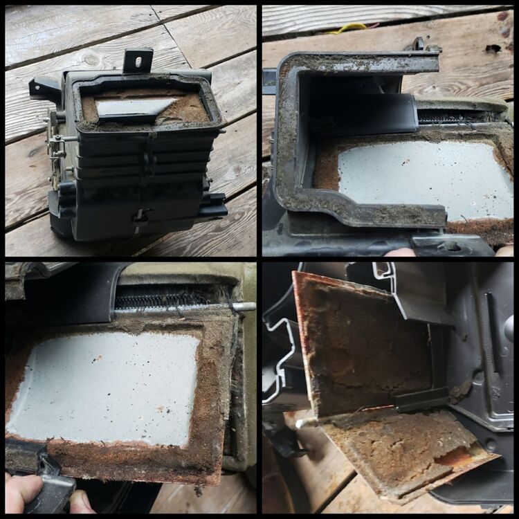

  2. Alright, well I put on my big boy pants and unbolted the dash enough to lift it and got an articulating wrench in there. The dash was less of a PITA than I had imagined, but getting a wrench in was not easy. I updated my Imgur folder to site the complete removal for future users. With that done, I got it loose and out! Quick question: What kind of foam do I need to replace the weather stripping? Is it necessary to re-foam that whole flapper? Thanks again!!!

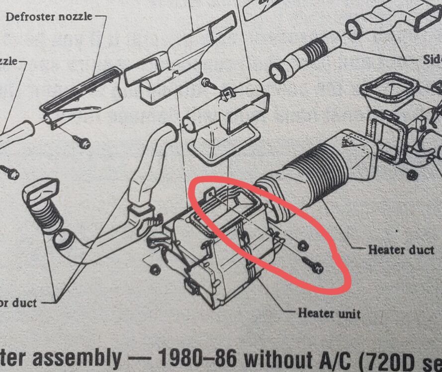

  3. Alright guys, got everything taken apart and ready to pull the heater... except that one bolt in the back. Looks like it rests right behind the center ventilator duct T splitter thing. At this point do I need to pull the dash? Not sure how I'll get to that screw unless I just loosen the dash and shimmy it up? Anyway, here's pictures of my total progress: https://imgur.com/a/Y7V8QfL Part 2: https://imgur.com/a/yQTQwN7 And attached to this post is the diagram with the screw I can't get to(yet). Thanks again, guys!

  5. Update: solved and documented removal with photos and notes here: https://imgur.com/a/yQTQwN7 https://imgur.com/a/Y7V8QfL Happy to give back to this amazing community, thanks again!!! Hey guys! Tried my best finding an answer on my own but couldn't find anything relative to the 1979-1983 720. Do I need to remove the entire dash to remove the heater core on this one? My manual is kind of incomplete on this section, doesn't really say. Trying to save myself the hassle if I don't need to fully disassemble the dash. Thanks in advance!
