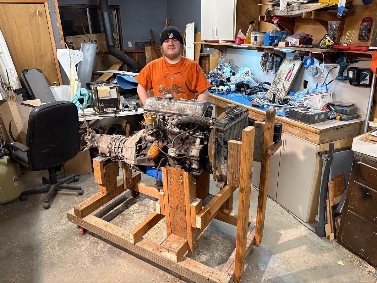

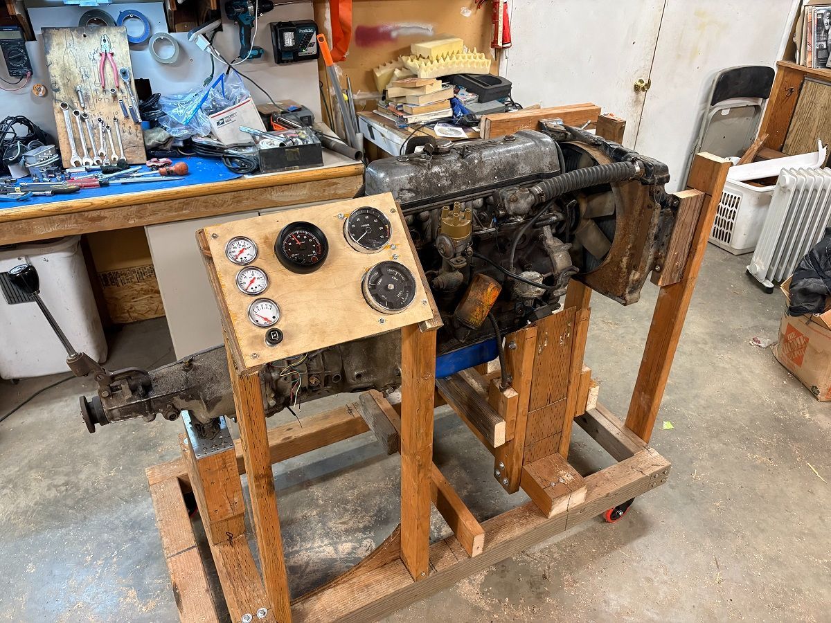

  11. Cool stuff! Good post. The more I thought about a pseudo dyno measuring RPM acceleration, I realized I'd have to estimate all the mass throughout the system...crank pulley, crank, flywheel, etc. That could get ugly fast! So i'll continue to ponder, but it's not on the schedule. Last weekend we got a lot done. We got the exhaust installed with respect to the pipes, haven't finished a bracket yet. We figured out where to place the battery, and I actually found some fat copper cable stock I knew I had somewhere (shop cleanout of packrattage paid off!) I even had four battery clamps, new! Red and black 2 gauge wire, it's pretty huge. (It was for a man lift battery at work) The cables even had ring terminals on one end already...the right size for the starter terminal! We roughed out how to use the existing engine bay harness for it's alt/regulator connections, and how to tap into the harness to get to the hot wire coming to the instrument cluster and ignition switch. Then we connectorized a bunch of wires to start plugging systems together. We now have the instrument panel hot, the run switch installed, the start switch installed, the voltage meter connected, and status lights. It's pretty cool to create something and get progress! You flip the master switch (with red fast kill cover), the green indicator turns on indicating system power and the voltmeter comes to life. Push the starter switch, and the yellow indicator comes on indicating start position. The wire to the starter is done, but of course will never be connected until the Big Day. We did test voltage at the solenoid end, it will initiate the starter just fine. We also tested the starter on the bench, it works. What does not work is the stock 4 instrument cluster ammeter. When wired in, we had nothing but failure on the panel. We pulled the wires, and did a check from terminal to terminal. Open circuit, when an ammeter should return zero or very low ohms. Nope. Infinite resistance...no connection. Damn. Ordered a ten buck ammeter. Connected both cables to one post to short them together and bypass the ammeter for now. We had another crazy idea after spotting capped vacuum ports on each intake runner pair. Would it be useful to have *two* vacuum gauges, one after each carb? Helpful for tuning? I dunno. I suspect the balance tube between the intake runners might keep the different paths from reading very differently unless the carbs are wildly out of sync, which is easy enough to determine anyway. However, for fine tuning the flow balance it would sure be nice if this wasn't the case. On the fence there, might be an interesting experiment, and who doesn't love more gauges on a test panel? We also implemented a simple hinge on the instrument panel so you can tilt it up from the designed 45 degree viewing angle to 90 degrees in order to access the wires behind the panel with ease. A big improvement. I decided to order an electric fuel pump so we could set up the float bowls without running the engine. I started messing with them years ago, then dropped the project half way. One float bowl has the brass float, another has a plastic float from some retrofit kit, it will take some messing around to get them back in shape. I don't want to have to try to run the engine to do this fussy work. Pump spec is 3-6 psi, which I think is about right, and I have a mechanical regulator in the parts shelf if I need one.
  12. Did some reading. The mass of the existing flywheel should work, and a hall sensor sensor somewhere. Maybe on the crank pulley? This is all just spitballing, may be stupid!

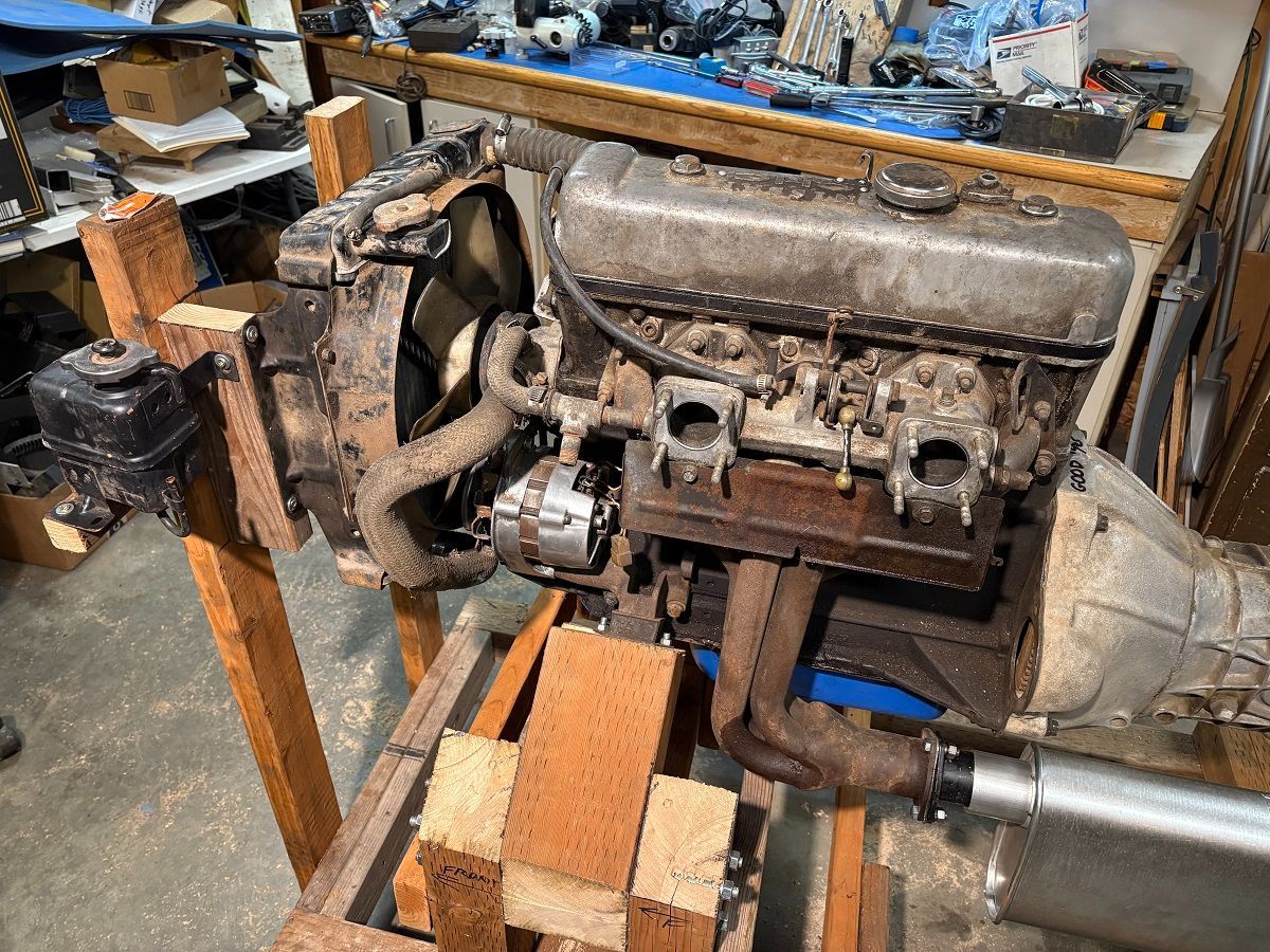

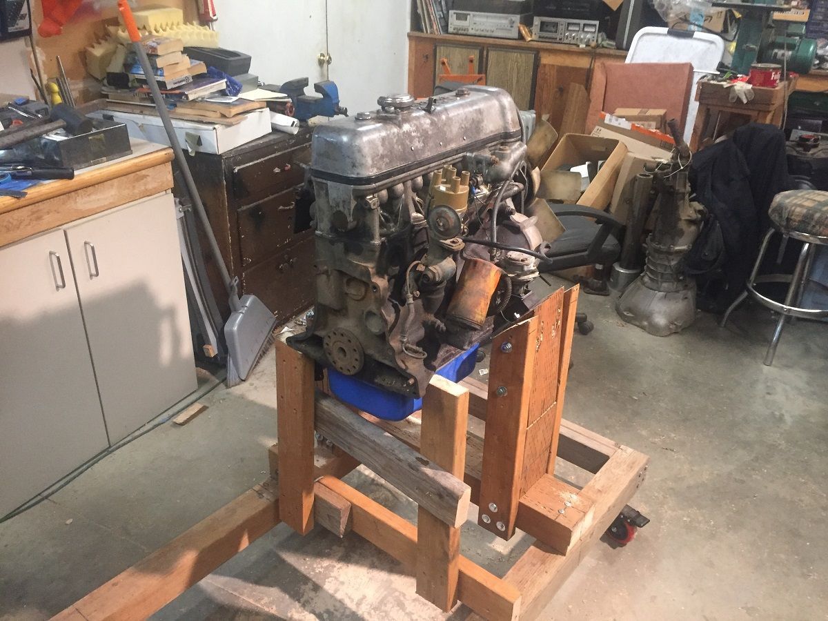

  13. We're a ways out on a run so we have time to sort that stuff out. Basic to-do list: - finish wiring harness - finish control panel gauges and switches - add more cross braces to stand - finalize exhaust and brackets - fuel plumbing and fuel tank (7 gallon marine tank with fuel pickup, for small outboard motors) - install battery position - radiator -> pressure tank hose - inspect upper tensioner - oil change and filter - transmixer oil change - fix choke cable (a kink in one of the two cables, in the box shaped upper housing means cable will not 'push' into sleeve when pushing knob in, it just bends and will not push into the sleeve) - come up with throttle cable system. Maybe the choke cable setups for a lawn tractor will work. - pull pan and retorque the bottom end? Includes slathering oil on journals while they're open. - coolant fill of course. Then I had some odd ideas about a possible ghetto dyno setup, using lateral thinking. Normally a dyno presents a mechanically resistive load for the engine to turn. This involves all kinds of large, heavy, fancy load mechanisms from mechanical to electric (turn a big generator which feeds a huge resistive load). I thought hmm, maybe one could get partway there via a simpler mechanism. I wonder if a flywheel style disk could be fitted onto a splined sleeve for the trans output shaft. Then you mark this flywheel, or print up some segments/teeth which go around the rim and act as an encoder of sorts. Then you'd use an RPM meter like the one I use for model aircraft propellors to measure RPMs. At this point, the idea is to measure the rate of change when you hit the throttle. You know the mass of the flywheel and it's dimensions, you should be able to figure out the moment of inertia, and thus calculate the power necessary to accelerate the flywheel at the rate measured. This would not of course measure static power at a given output, for that you need the standard dyno system. But you might be able to come up with some useful numbers during acceleration. Just an idea. How crazy is it? I guess I'd then need to add a clutch, since just leaving it in a gear during start would probably present all kinds of problems not present if you do the same thing with the output trans shaft free of added rotational mass

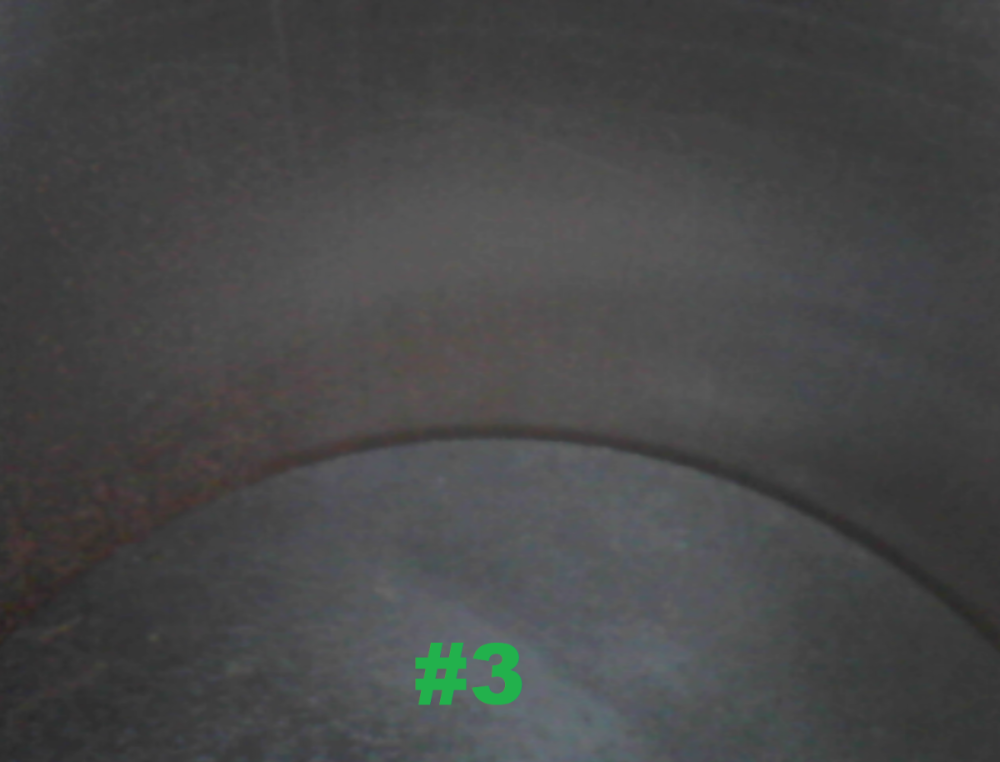

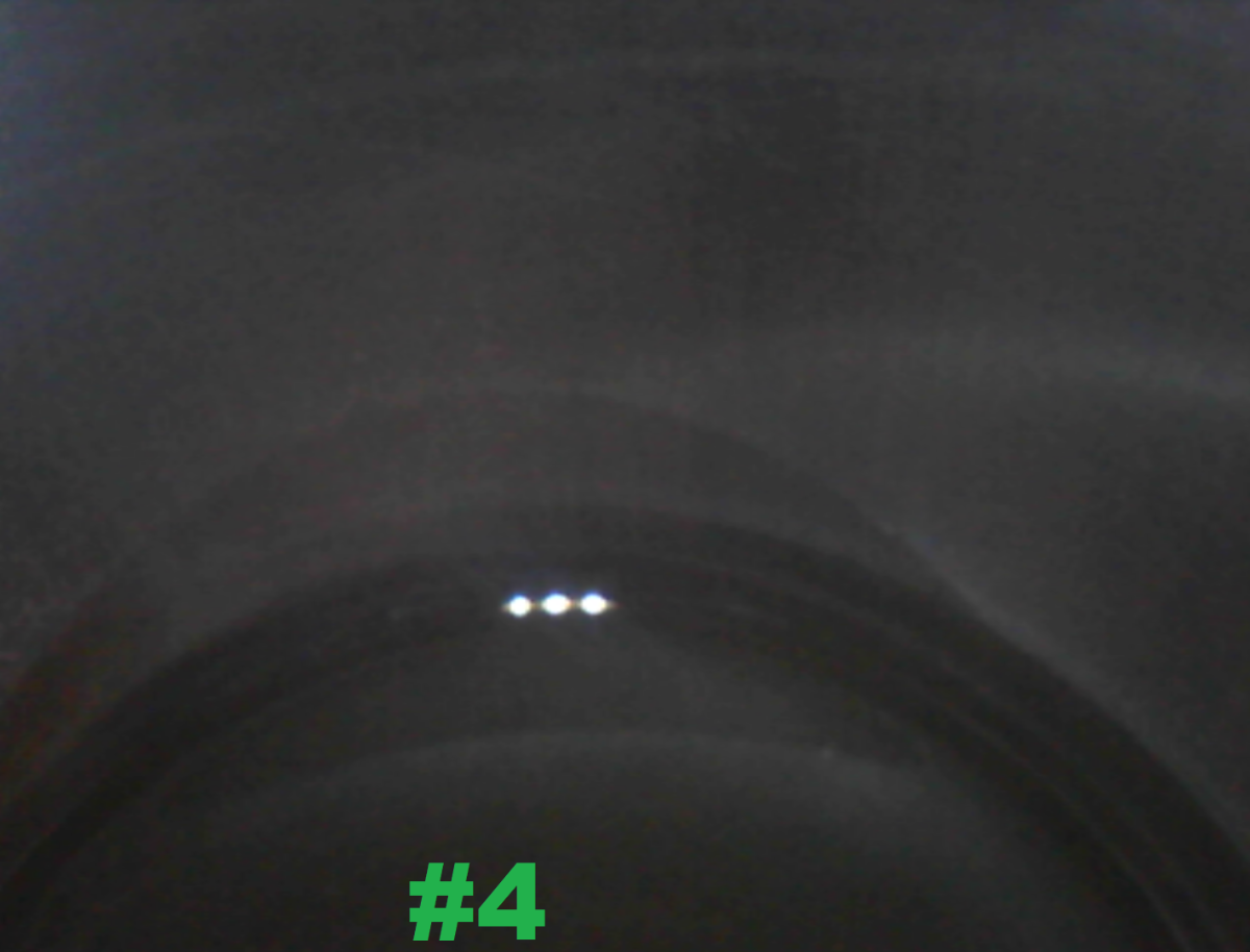

  15. Race miles or road miles? That sounds odd compared to my other Nissan engines. I'm not seeing the wear. Regardless, we're going to pull the tensioner on top and evaluate it and get a better look at the big guide. A look in the parts cabinet shows I had some foresight when I worked at Nissan while going to school in the early 90's and had access to cost plus 10 pricing. Upper guide, upper and lower chains, NIB! When we do get it running and get to a compression test I'll be very interested in the numbers. I seem to recall 185 or better and even across the cylinders as acceptable results for a used engine, I wonder what peak numbers would be on a fresh one. Also, was doing more reading and one guy said to recheck the torques in everything on the bottom end, crank and connecting bolts. Not sure about this...do I get good torques breaking them loose to retighten them?
